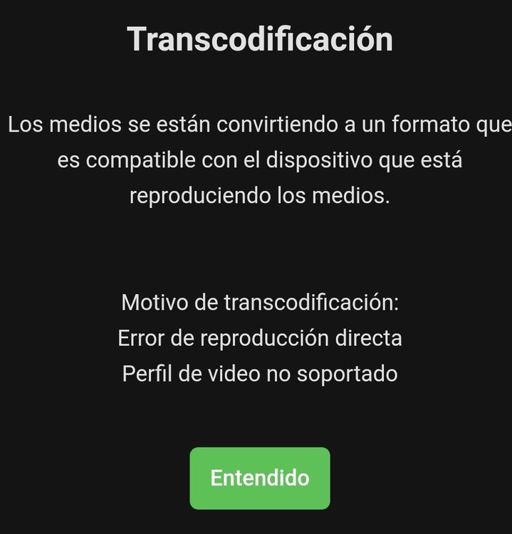

rocafebo 0 Posted March 18, 2021 Posted March 18, 2021 (edited) A few days ago I bought the Xiaomi TV Stick. For streaming it works very well, I have no complaints. But even though it is compatible with the x265 codec, every time I want to play a video in that format, Emby starts transcoding to h264 ... why does this happen? Edited March 18, 2021 by rocafebo
ebr 16338 Posted March 18, 2021 Posted March 18, 2021 Hi. Can we please look at an example? Also, have you looked at either the server dashboard or the stats feature in the app to learn why it is transcoding?
rocafebo 0 Posted March 18, 2021 Author Posted March 18, 2021 5 minutes ago, ebr said: Hi. Can we please look at an example? Also, have you looked at either the server dashboard or the stats feature in the app to learn why it is transcoding? The transcoding is from x265 to h264... the problem is the video codec...
ebr 16338 Posted March 18, 2021 Posted March 18, 2021 18 minutes ago, rocafebo said: The transcoding is from x265 to h264... the problem is the video codec... What, exactly, did the transcode reason say?
rocafebo 0 Posted March 18, 2021 Author Posted March 18, 2021 1 hour ago, ebr said: What, exactly, did the transcode reason say? With VLC as external player is direct play, transcoding happens with native player.

ebr 16338 Posted March 19, 2021 Posted March 19, 2021 Looks like maybe HEVC 10 and the device says it doesn't support that. You could try the beta of the app to see how it behaves.

ebr 16338 Posted March 19, 2021 Posted March 19, 2021 Just now, rocafebo said: If I use VLC as external player then the movie plays without transcoding... the device is compatible with h265 The fact VLC plays it does not mean the "device" supports it. Also, it isn't just "HEVC". There are different types of HEVC. But, please try the beta and let us know your experience. Thanks.
rocafebo 0 Posted March 19, 2021 Author Posted March 19, 2021 Just now, ebr said: The fact VLC plays it does not mean the "device" supports it. Also, it isn't just "HEVC". There are different types of HEVC. But, please try the beta and let us know your experience. Thanks. Ok I didn't know that. I'll try with beta.
rocafebo 0 Posted March 21, 2021 Author Posted March 21, 2021 On 3/19/2021 at 12:16 PM, ebr said: Looks like maybe HEVC 10 and the device says it doesn't support that. You could try the beta of the app to see how it behaves. Beta version fix the problem. Playback is done without encode. Thank you for support.
