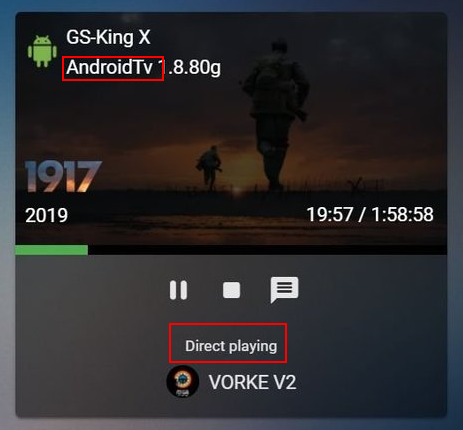

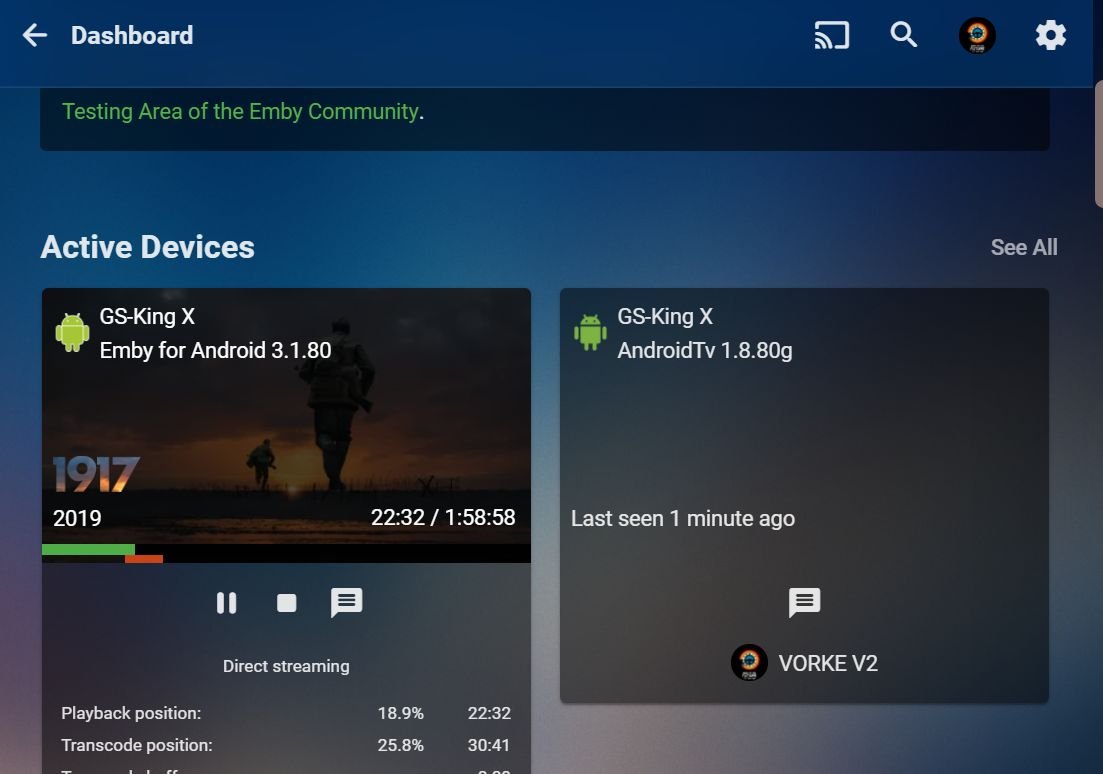

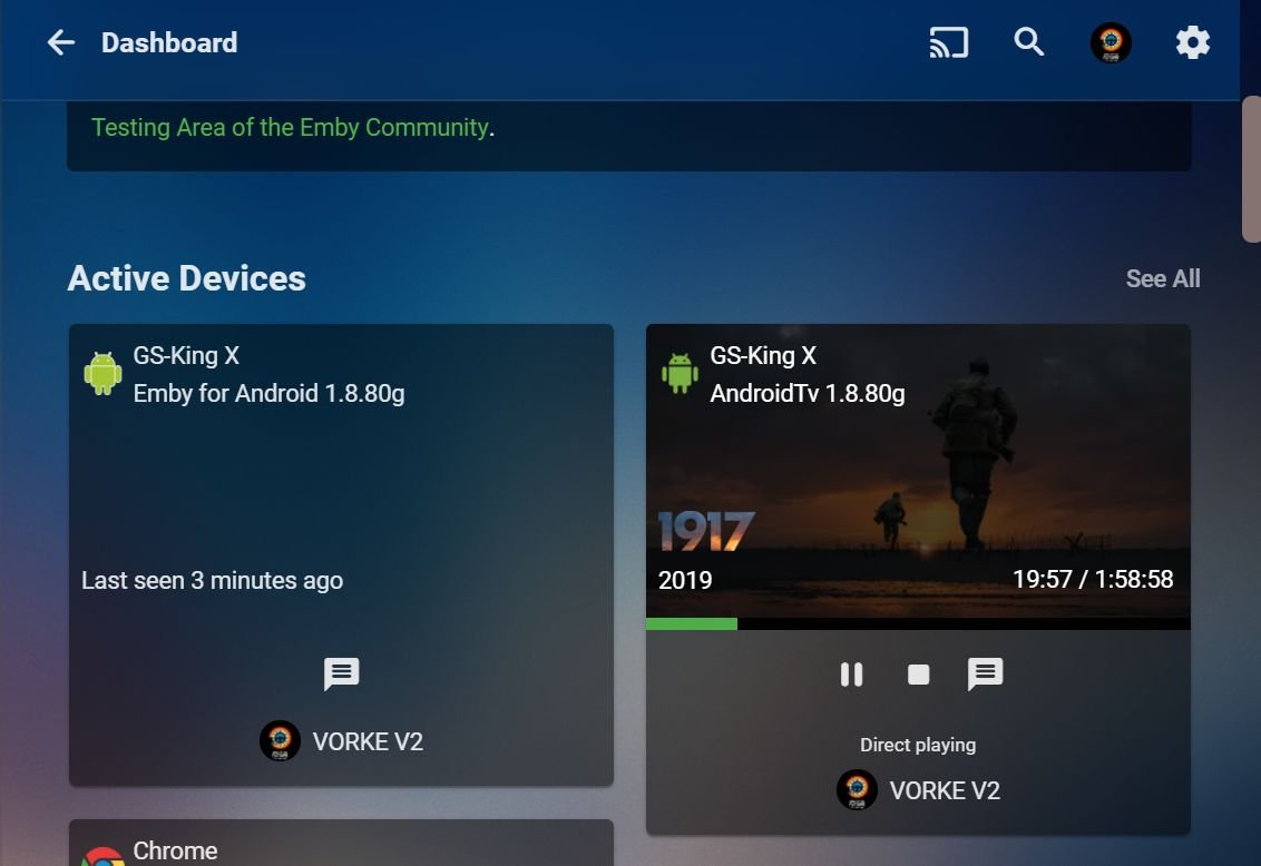

clarkss12 304 Posted March 17, 2021 Posted March 17, 2021 6 minutes ago, CBers said: One is the official Android TV version add the other is tee Android Mobile version. The Android Mobile version is primarily for phone and tablets, but it now also runs on Android TV devices. The Android Mobile app is also being used to test changes before they are added to the Android TV app. Thanks. Thanks, now I see. The Mobile version direct plays, where as the Android for TV version direct streams, as seen in the pics I included.... Both versions have really matured compared to the earlier versions.
flakie 11 Posted March 17, 2021 Author Posted March 17, 2021 13 minutes ago, clarkss12 said: I really, don't understand what you mean by 6 channel audio?? I believe it was eas3 6-channel (that is whatt emby reported in the movie information). Or something like that. These were not my rips. They were ones I downloaded to see if they would play in place of my 5.1 rips. I had no idea what the audio was when I downloaded and have since deleted them. I have converted my 5.1 to stereo now and working fine. Still a mystery why 5.1 play sometimes and sometimes are silent. Probably software issue on my android box (at a guess). I really like this Android box and the only issue I have come across is the buggy audio in Emby (not that I am saying it is an Emby problem).
ebr 16338 Posted March 17, 2021 Posted March 17, 2021 8 minutes ago, clarkss12 said: The Mobile version direct plays, where as the Android for TV version direct streams According to your images, you got that backwards...
clarkss12 304 Posted March 17, 2021 Posted March 17, 2021 1 minute ago, ebr said: According to your images, you got that backwards... 1.8.80 is NOT the mobile version? The 3.1.80 is the one from the Google Play store........
ebr 16338 Posted March 17, 2021 Posted March 17, 2021 Just now, clarkss12 said: 1.8.80 is NOT the mobile version? No, as indicated by the "TV" in the app name .

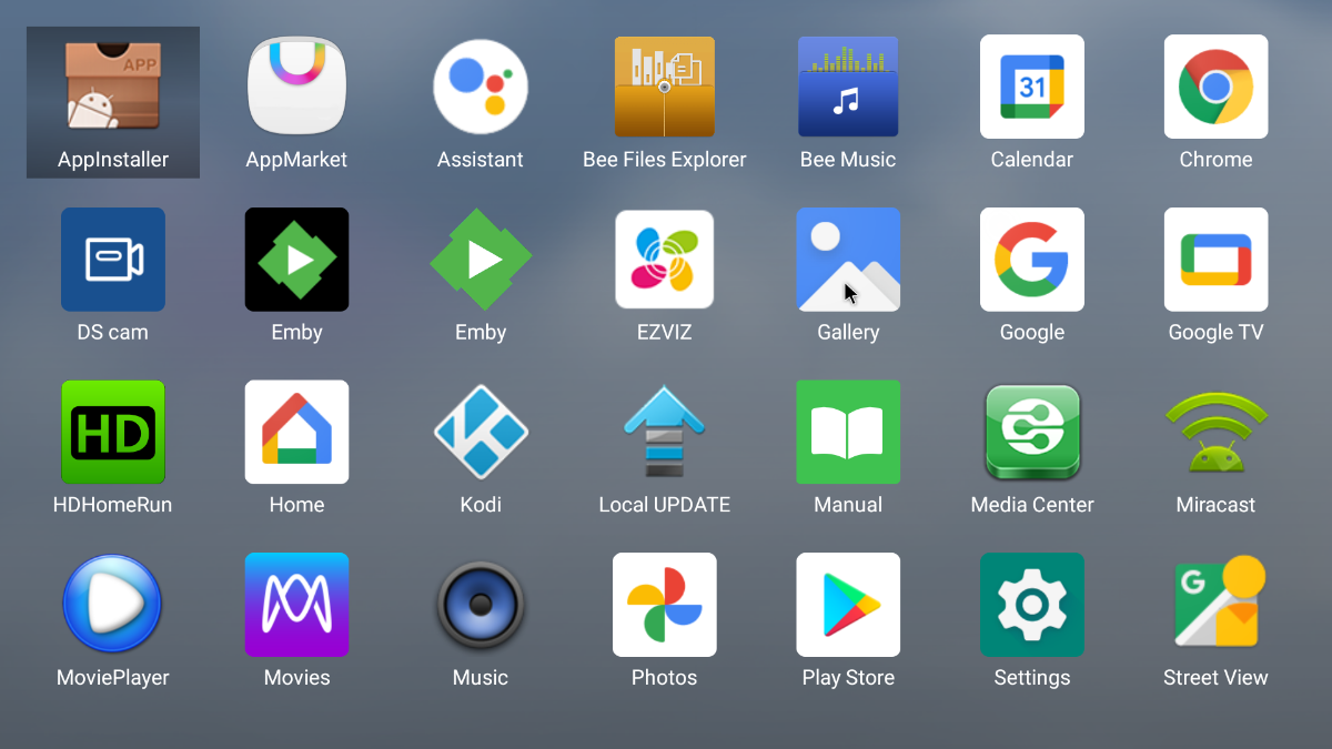

clarkss12 304 Posted March 17, 2021 Posted March 17, 2021 6 minutes ago, ebr said: No, as indicated by the "TV" in the app name . This is what I see.

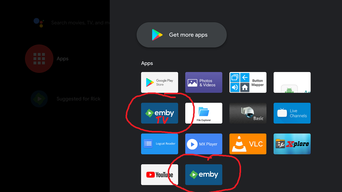

ebr 16338 Posted March 17, 2021 Posted March 17, 2021 2 minutes ago, clarkss12 said: This is what I see. That's because you are not on an Android TV device. So you are seeing a mobile launcher. In the store and in your images above, the app has a "TV" designation.
clarkss12 304 Posted March 17, 2021 Posted March 17, 2021 (edited) Still confusing for my simple brain.. I see "Android Tv", but Emby for Android is different than Android TV OS version........ Too much to distinguish between the " THREE" different versions....... Easy for you to distinguish, but not so much for me, that rarely uses the pure Android boxes... Emby Android TV Release Notes (BETA) is confusing for me. Edited March 17, 2021 by clarkss12
