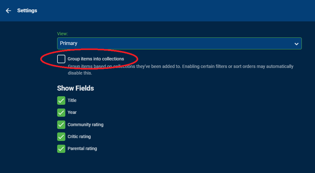

Carlo 4561 Posted October 19, 2021 Posted October 19, 2021 (edited) Just so you know, you don't have to have Collections showing in the main menu (My Media). Collections will also show up as a tab in the Movie Library. Each user can also choose to group movies by collections as well in the main view using this from the 3 dot menu. That would show only the collection in your movie view vs all the movies individually. PS sorry for any confusing on the sort order already covered. You can change it but it's system wide. It doesn't allow re-arranging specific items like you can in a playlist which is what I was trying (badly) to convey. Edited October 19, 2021 by cayars 1
