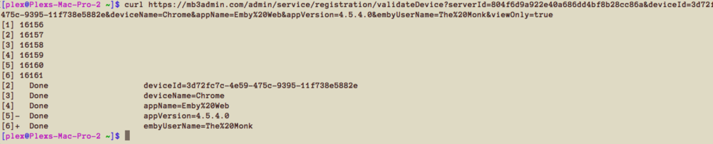

Monkrocker 2 Posted March 12, 2021 Author Posted March 12, 2021 Just tried the 404 url with curl and I get this result. See attachment.

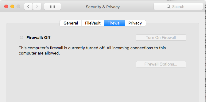

ebr 16309 Posted March 12, 2021 Posted March 12, 2021 A browser or curl will not be a good test as these things are managed by process. So the Emby server will need to have access. You are on MacOS, correct? That is going to be locked down pretty tight and I'm sure there will be some sort of configuration needed to get past its firewall.
Monkrocker 2 Posted March 12, 2021 Author Posted March 12, 2021 (edited) 2 minutes ago, ebr said: A browser or curl will not be a good test as these things are managed by process. So the Emby server will need to have access. You are on MacOS, correct? That is going to be locked down pretty tight and I'm sure there will be some sort of configuration needed to get past its firewall. But a curl test will tell you if my machine is blocking the URL. (It's not.). And it's High Sierra because that's as high as I can get on this machine, since it's an older Mac Pro. Edited March 12, 2021 by Monkrocker
ebr 16309 Posted March 12, 2021 Posted March 12, 2021 1 minute ago, Monkrocker said: But a curl test will tell you if my machine is blocking the URL No, it really won't because firewalls block specific processes not just URLs. @cayars do we have specific firewall instructions for Mac?
ebr 16309 Posted March 12, 2021 Posted March 12, 2021 Does this help? https://support.apple.com/guide/mac-help/firewall-preferences-mh11783/10.13/mac/10.13
ebr 16309 Posted March 12, 2021 Posted March 12, 2021 The problem you are having is with an outgoing connection, though. I would turn the firewall back on and configure it appropriately.
