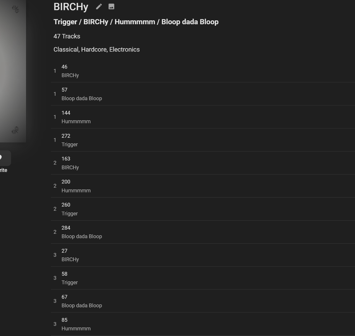

I picked up a new series of albums. Emby keeps combining all four discs as if they are one album. The string in the "album" fields are similar, but are different. Now even if I change the "album" field to something completely different and off-the wall ("ZZ Top's Greatest Hits"), it still combines them all into the same album.
The problems are: 1). Playing the big "mega-album" plays all the track #1's, then all the track #2's, etc. 2) THere is no way to play any one of them in sequence.
HELP!!!!

 I customized the ID3 tracks myself. Arduously. Painstakingly.
Just now, I removed all the files from my library folder, changed literally everything to something completely different, then added them back into the library, which seemed to work. Then I changed one of the discs back to the proper tags. All good. Then a second one. They remained distinct. Then I did the other two and BAM - grouped them all right back into the same album title.
FRUSTRATING.

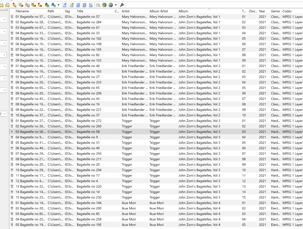

It is four distinct albums (not separate discs of a multi-disc set):
  • "John Zorn's Bagatelles, Volume 1" by Mary Halvorson Quartet
  • "John Zorn's Bagatelles, Volume 2" by Erik Friedlander and Michael Nicolas
  • "John Zorn's Bagatelles, Volume 3" by Trigger
  • "John Zorn's Bagatelles, Volume 4" by Ikue Mori

you dont have a discnumber for each disc!
fix that and it should work unless you have other issues with you metadata
But they are *not* separate discs in one album, they are completely separate albums. The disc number for each disc is "1."
If they have separate album titles, they SHOULD be grouped in separate albums, right???? Even if they are close, they should be separate, right?

your discnumber field looks blank in the image you posted
no - depends on other things like mbz ID's and folder structure
and do you have each volume in a separate album folder?
folder format should be root\Albumartist\album\song
any folder with songs is assumed to be an Album - which might be your problem
AH - just caught your note about folder structure. That solved it. Whew! Thanks.
