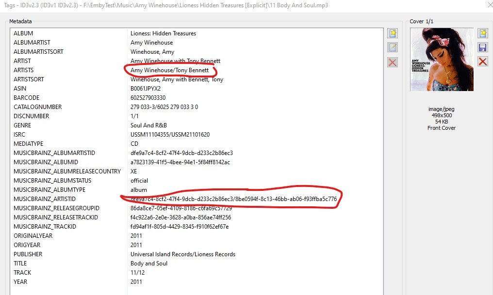

PenkethBoy
Sorry dont follow your logic
You can still have BR as an Artist if you want besides LP being the AA
Having two tags for the same thing confuses Emby - so have one artist tag/MBz tag but have both "Artists" separated by a / or ; e.g. 1207648431_Annotation2021-03-09224131.thumb.jpg.91f271e2033a53f9a8cee3292b75030c.jpg
