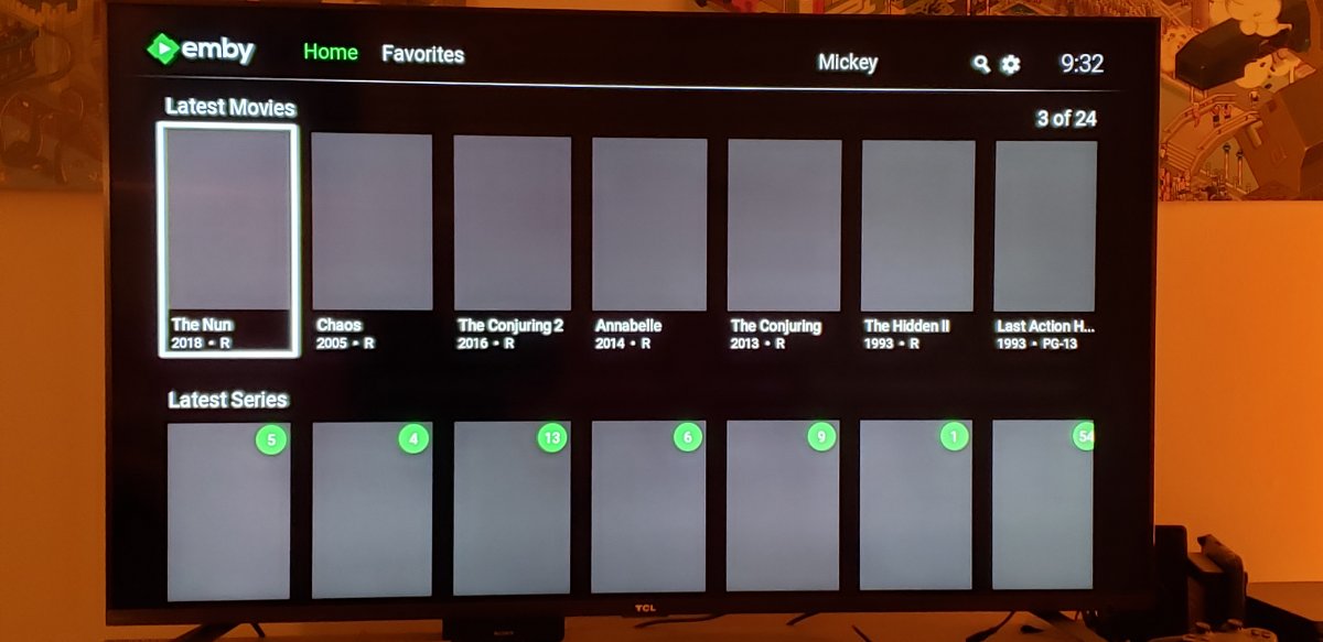

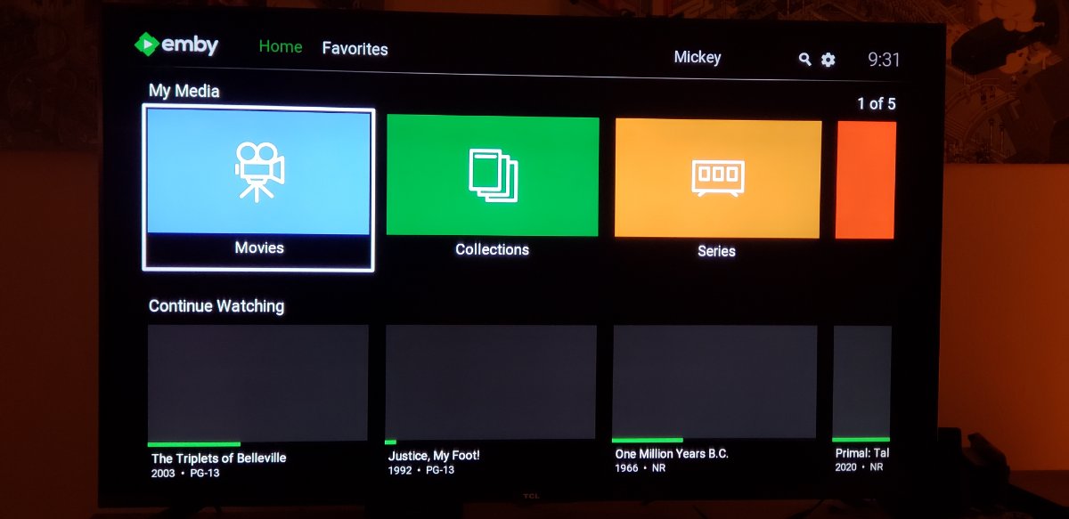

MickeyMori 47 Posted March 8, 2021 Posted March 8, 2021 Starting about a week ago, most of the images on the Roku app have been replaced with grey boxes, with a few exceptions (eg., the logoart.pngs ). Other clients are working fine - iPad, Android, Web are all displaying images correctly. Anyone else having a similar issue?

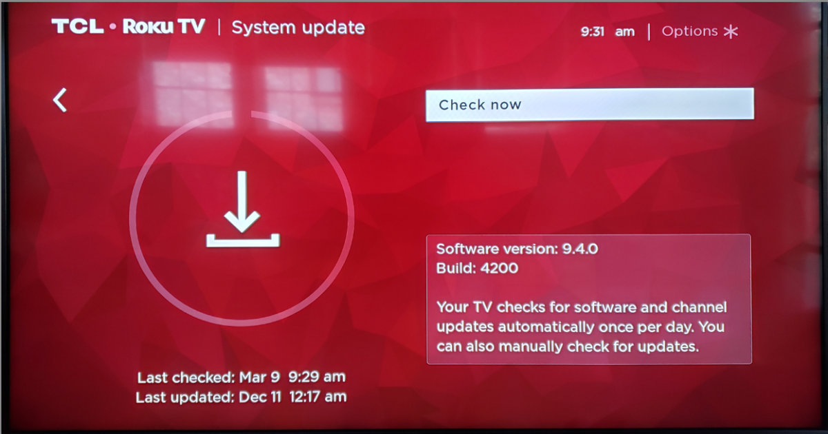

MickeyMori 47 Posted March 8, 2021 Author Posted March 8, 2021 One of the TCL 6-Series with Roku. Model and version info below. Roku TV: 7120X TCL model: 55R615 Software version: 9.4.0 build 4200-30

speechles 2062 Posted March 8, 2021 Posted March 8, 2021 Can you show us a picture of the screen when it does this? I have a TCL Roku TV 7130X and have no problems with images.
speechles 2062 Posted March 8, 2021 Posted March 8, 2021 (edited) I know what is causing this now. http://192.168.1.241:8096/emby/Items/94766/Images/Primary/0?EnableImageEnhancers=true&tag=3a9a55d22aab4e1cf89f968b9eb871d7&maxwidth=216&maxHeight=1080&quality=80&accept=webp Roku has recently added WEBP as an supported image type. We added the ability to support this in our app but it was causing performance issues. We are re-evaluate how to present WEBP to the Roku again and will have something to address that later. But in the meantime... https://my.roku.com/account/add?channel=EmbyBeta Can you try with the URL above which will install the Emby Beta for Roku. Using the Beta app should produce images for you once again. Let us know if this works for you. Thanks for reporting. NOTE: PNG was not affected which is why your LOGO had no issues with display. Edited March 8, 2021 by speechles
MickeyMori 47 Posted March 8, 2021 Author Posted March 8, 2021 Installed the Emby Beta, but still getting the same results. Most images aren't displaying. Out of curiosity, I replaced one of the movie posters with a PNG version and that renders perfectly. So at least that confirms that PNGs are not being effected. Also explains why my custom My Media images are working, they're all PNGs, too. And thanks for all your help!

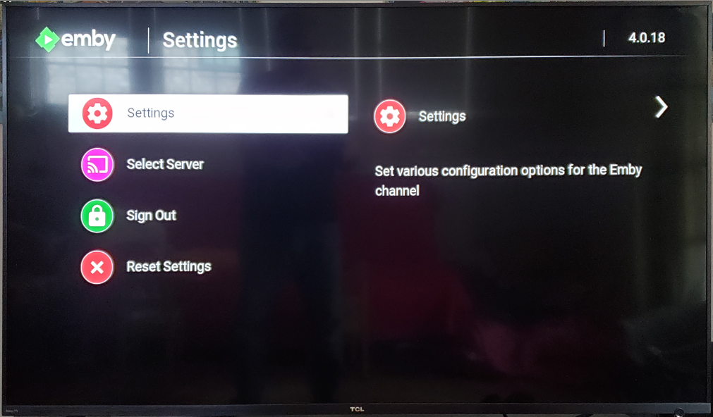

ebr 16335 Posted March 9, 2021 Posted March 9, 2021 Hi. Can you please confirm the version number of your Roku app (from the settings screen)?
MickeyMori 47 Posted March 9, 2021 Author Posted March 9, 2021 Hey. I wasn't sure if you meant the version number for Roku or the Emby app running on Roku, so here's both: Roku: Emby:
ebr 16335 Posted March 9, 2021 Posted March 9, 2021 Okay, I thought that change had made into the last release but, unfortunately, it was just after it. We will get a new beta up that should resolve this for you.
