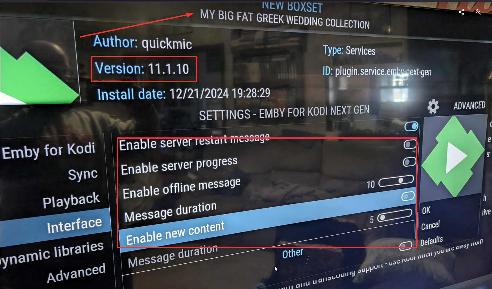

TheFreeMan 36 Posted January 8, 2025 Posted January 8, 2025 I'm getting update notices even though I believe I have them turned off. Am I looking at the wrong setting(s) or is this a bug? These settings are from the "base" Emby for Kodi Next Gen Add-on, not from the "(Video)" or "(Audio)" versions (though I understand that they just link back here). I'm running Emby 4.8.10.0 if that matters
quickmic 1709 Posted January 9, 2025 Author Posted January 9, 2025 Did close the config by pressing "OK" on not simply used the back button. Only OK saves the settings.
TheFreeMan 36 Posted January 9, 2025 Posted January 9, 2025 (edited) I never even saw the OK down there. The weird thing is, though, that I turned off "Enable new content" and when I went back in to check on it, I'd swear that it was still turned off! Edited January 9, 2025 by TheFreeMan 1
Trapperjohn61 24 Posted January 9, 2025 Posted January 9, 2025 2 hours ago, TheFreeMan said: I never even saw the OK down there. The weird thing is, though, that I turned off "Enable new content" and when I went back in to check on it, I'd swear that it was still turned off! It sounds like to me the skin you are using may not have an ok but a checkmark which is the same as ok. i think a picture of the screen showing the options when you just choose configure on the Emby plugin it would be clearer to see the equivalent of your skin for the ok option. Bryan
TheFreeMan 36 Posted January 9, 2025 Posted January 9, 2025 1 hour ago, Trapperjohn61 said: a picture of the screen Look up 4 messages
Trapperjohn61 24 Posted January 9, 2025 Posted January 9, 2025 I see the ok button on the right side of your screenshot sorry I missed it
Trapperjohn61 24 Posted January 9, 2025 Posted January 9, 2025 Basically turn on new content then click on on the right
