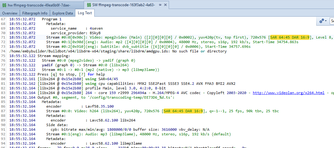

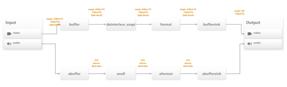

softworkz 5135 Posted March 13, 2021 Posted March 13, 2021 Hm, that's weird, the aspect ratio doesn't change anywhere:
softworkz 5135 Posted March 13, 2021 Posted March 13, 2021 OK, could have seen that from the log files as well. I've been a bit focused on the processing, because that's typically where the aspect ratio gets screwed.. With both, sw and hw, it's SAR 64:45 DAR 16:9 for input and output.
Tau512 15 Posted March 13, 2021 Author Posted March 13, 2021 thats kinda where i got to trying to understand the logs the other day; the SAR/DAR's dont change between SW & HW logs and saw no reference to 4:3. ...so that means emby is not doing anything then... meaning it's lower level at hardware/driver and outside of what emby can see?

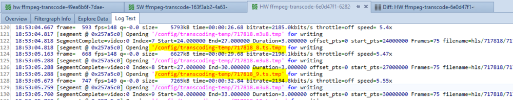

softworkz 5135 Posted March 13, 2021 Posted March 13, 2021 OK, next step would be to analyze the output. Could you please post two segments from each run (sw/hw). First one and 5th one?
softworkz 5135 Posted March 13, 2021 Posted March 13, 2021 Either it's in the segments, or it's the client making different assumptions up-front. Was it in one, several or all clients?
Tau512 15 Posted March 13, 2021 Author Posted March 13, 2021 it's in all clients that i've tried; win10 theatre, LG tv webos app, and shield. currently doing all my testing on the win10 theatre as it's easy on a dual screen setup... how do i generate the segments - i'm confused on exactly what to do there?
Carlo 4561 Posted March 13, 2021 Posted March 13, 2021 On 3/5/2021 at 3:09 PM, veehexx1 said: tuner is TBS6981 Sorry for the off question. Is this tuner setup in Emby or are you doing recording outside Emby?
Tau512 15 Posted March 13, 2021 Author Posted March 13, 2021 emby.zipattached zip with HW & SW with segmentsa 1&5
Tau512 15 Posted March 13, 2021 Author Posted March 13, 2021 Just now, cayars said: Sorry for the off question. Is this tuner setup in Emby or are you doing recording outside Emby? outside of emby. it's configured in TVHeadend and using m3u tuner in emby
Tau512 15 Posted March 13, 2021 Author Posted March 13, 2021 ... so transcoding isnt filling the DAR & SAR info so it's falling back to a 'safe' 4:3 default?
