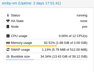

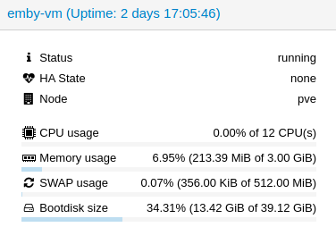

chudak 24 Posted March 4, 2021 Posted March 4, 2021 Hi all I run emby on ubuntu VM (proxmox). See an odd memory allocation on an idle emby instance allocating ~2GB memory and never releasing it. This is high memory (nothing actually is running at all): This is after fresh emby restart: No problems seeing because of this, but feels odd. Anybody has an explanation ? Thx
chudak 24 Posted March 4, 2021 Author Posted March 4, 2021 40 minutes ago, Luke said: Hi, let's look at an example: Thanks. That was an example Are you seeing/expect the memory be released at some point ? Or this is a normal operation?
mastrmind11 722 Posted March 4, 2021 Posted March 4, 2021 1 hour ago, chudak said: That was an example Are you seeing/expect the memory be released at some point ? Or this is a normal operation? what is your server doing (or just did) when you see that? I rarely see over 200MB used during streaming or transcoding.

chudak 24 Posted March 4, 2021 Author Posted March 4, 2021 6 minutes ago, mastrmind11 said: what is your server doing (or just did) when you see that? I rarely see over 200MB used during streaming or transcoding. Nothing in last 10 hours, that's why wondering ...

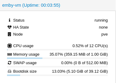

mastrmind11 722 Posted March 4, 2021 Posted March 4, 2021 seems weird. try limiting your VM to like 500MB of memory, see what happens
chudak 24 Posted March 4, 2021 Author Posted March 4, 2021 1 minute ago, mastrmind11 said: seems weird. try limiting your VM to like 500MB of memory, see what happens Interesting idea, will try 1GB
chudak 24 Posted March 4, 2021 Author Posted March 4, 2021 7 minutes ago, chudak said: Nothing in last 10 hours, that's why wondering ... Streaming 4 1080 streams with no problem. Maybe it's unhappy with 3 GB ?!
Q-Droid 1011 Posted March 4, 2021 Posted March 4, 2021 That doesn't seem like too much and it could be that the VM is reporting memory usage as resident + cache. But even with that said my emby server process sits at around 1.5GB resident when idle and a few days of uptime. Mem usage goes up and down with use but tends to settle there.
chudak 24 Posted March 5, 2021 Author Posted March 5, 2021 Update - on allocated 1GB RAM usage seems to be more reasonable around 200-260 MiB. It's very interesting why on 3GB it behaves differently, maybe LCX/Proxmox issue not emby's. Still keeping an eye on it .....
