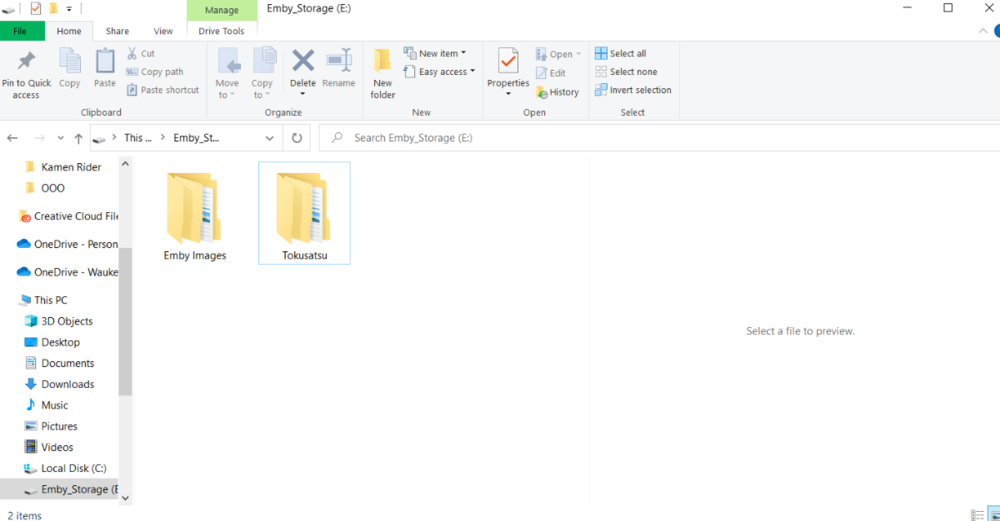

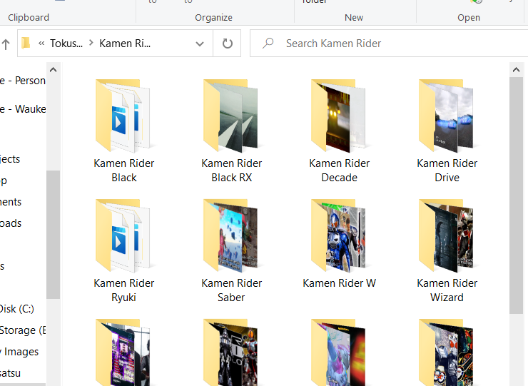

VivaDandy 0 Posted March 4, 2021 Author Posted March 4, 2021 2 minutes ago, GrimReaper76 said: How did you add those seasons under your Library setting: as individual folders or single Kamen Rider folder? My library that I have added to my server is the "Tokusatsu" folder from image 1. Emby usually in the past has kept everything in the following folders from image 2 separated.

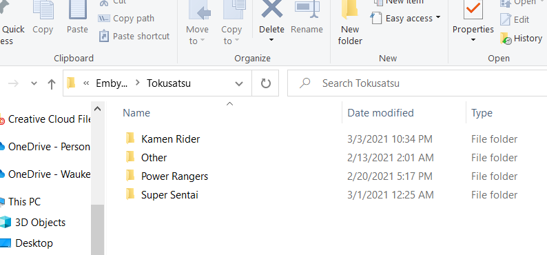

GrimReaper 4861 Posted March 4, 2021 Posted March 4, 2021 Just now, VivaDandy said: My library that I have added to my server is the "Tokusatsu" folder from image 1. Emby usually in the past has kept everything in the following folders from image 2 separated. Merge option applies to series spread accross multiple folders - in your case they are all inside single folder, as per your path settings, Kamen Rider has been identified and seasons underneath presented so. You need to move those seasons folder one level up, untick "Merge" option and rescan Library.
Solution VivaDandy 0 Posted March 4, 2021 Author Solution Posted March 4, 2021 1 minute ago, GrimReaper76 said: Merge option applies to series spread accross multiple folders - in your case they are all inside single folder, as per your path settings, Kamen Rider has been identified and seasons underneath presented so. You need to move those seasons folder one level up, untick "Merge" option and rescan Library. Okay so basically, and this could be wrong, what your saying is because all the folders have Kamen Rider in the name they'll merge no matter what. Taking all of them out of the folder that they're currently in one level and then unticking merge plus the re-scan is how it should work?
GrimReaper 4861 Posted March 4, 2021 Posted March 4, 2021 (edited) 5 minutes ago, VivaDandy said: Okay so basically, and this could be wrong, what your saying is because all the folders have Kamen Rider in the name they'll merge no matter what. Taking all of them out of the folder that they're currently in one level and then unticking merge plus the re-scan is how it should work? No, but because they are all placed inside single Kamen Rider folder. Taking them out should give the result you're after, yes. Edit: Alternatively, adding ...Tokusatsu\Kamen Rider instead of ...Tokusatsu as Library path would produce same result - but that would also affect all other series under 'Tokusatsu' folder. Edited March 4, 2021 by GrimReaper76 Append
