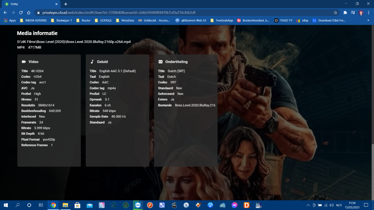

moviepalace4K 30 Posted March 15, 2021 Posted March 15, 2021 I have no idea why you guys need so much bandwidth with 4K movies. See picture

rbjtech 5337 Posted March 15, 2021 Posted March 15, 2021 Hi - Thanks for the offer, but it is technically impossible to compress a 80-90 Mbit HEVC file (which has ~30% better compression than H264 anyway) into a 6Mbit h264 file with comparable quality. Netflix use 15Mbit HEVC for a reason - and even that is poor and shows macroblocks during fast paced action and is not HD Audio. There are entire website and forums dedicated this topic - see doom9. If you are happy with the quality - great - I'm just answering your question about why other people have difficulty streaming 4K remux files as they are choosing to try and playback uncompressed versions of the original UHD disks in all it's professionally authored HDR/Dolby Vision and HD Audio quality/glory - not some bit starved streaming copy or worse. 1
moviepalace4K 30 Posted March 15, 2021 Posted March 15, 2021 So you are judging something that you have not seen yet? What you want to achieve you can only achieve on a local network or a 1Gbit fiber network with at least 40mb upload speed. So if you want to comment whether it is good / bad quality or not, check out my 4k library and try a movie.
Deathsquirrel 745 Posted March 15, 2021 Posted March 15, 2021 1 hour ago, Privateyes said: So you are judging something that you have not seen yet? What you want to achieve you can only achieve on a local network or a 1Gbit fiber network with at least 40mb upload speed. So if you want to comment whether it is good / bad quality or not, check out my 4k library and try a movie. I dunno if we're judging. Math is judging. As @rbjtech noted, what you're proposing is impossible. It sounds like you're happy with your video quality and that's great. That doesn't change the fact that it's much, much lower than the source data. You can't eliminate 90% of the video data plus convert to a less efficient codec and get comparable results. 4K video rips are 50-100Mbps for the video stream in my experience. 1
RanmaCanada 501 Posted March 15, 2021 Posted March 15, 2021 1 hour ago, Privateyes said: So you are judging something that you have not seen yet? What you want to achieve you can only achieve on a local network or a 1Gbit fiber network with at least 40mb upload speed. So if you want to comment whether it is good / bad quality or not, check out my 4k library and try a movie. Your movie is an overcompressed, H264 encode. It has no HDR, nothing that makes it better than a 1080p encode. In fact it is bitstarved. You would be better served with a high bitrate 1080p encode, which the original source for this movie has. All you've done is created an oversized turd. If you're going to attempt to shrink something this much, use HEVC of AV1 as they are designed for this use scenario, AVC/H264 is not. 1
