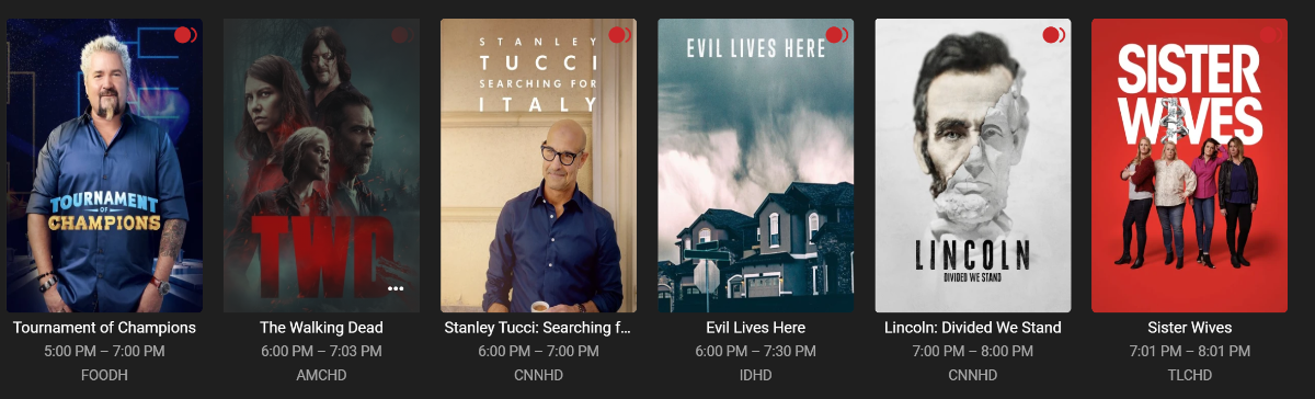

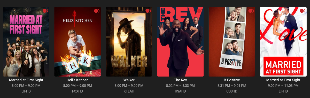

Sammy 790 Posted March 3, 2021 Posted March 3, 2021 An example of when six tuners are necessary: Six programs overlapping at 9pm..
