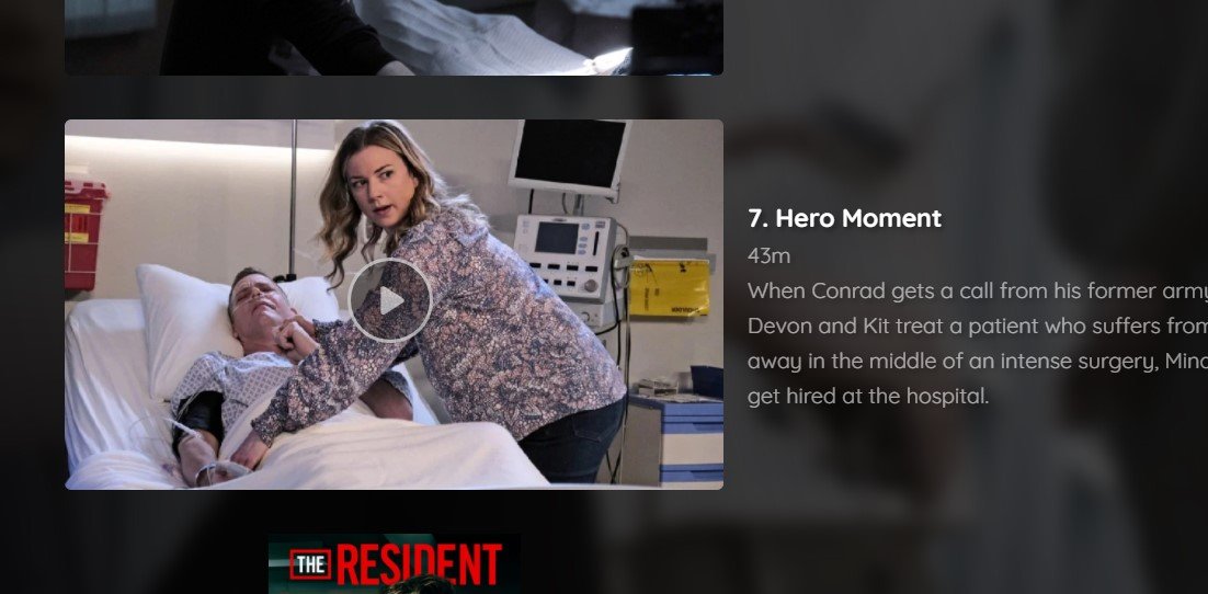

kaj 339 Posted March 3, 2021 Posted March 3, 2021 (edited) I've been seeing this random behavior in the last few weeks too, and creation date doesn't seem to be the answer. 1. Full TV library scan done yesterday. 2. Added Prodigal Son, Season 2, Episode 7. 3. Appears as added on Home Screen and Info Screen: This is happening randomly with many different shows. Latest Kim's Convenience added just now, acting the same way as Prodigal Son above. 4. But missing under the Season Info However, Resident (Episode 7) is showing correctly, also added today: Edit: Having investigated Prodigal Son, it seems that Season 1 episodes were not very well named. Having manually edited the episodes in Season 1 to the correct format, the 'missing' episode in Season 2 is now showing, as are the other episodes in other TV Shows. No library scan needed. Edited March 3, 2021 by kaj
