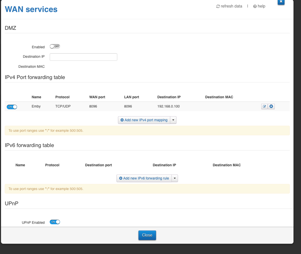

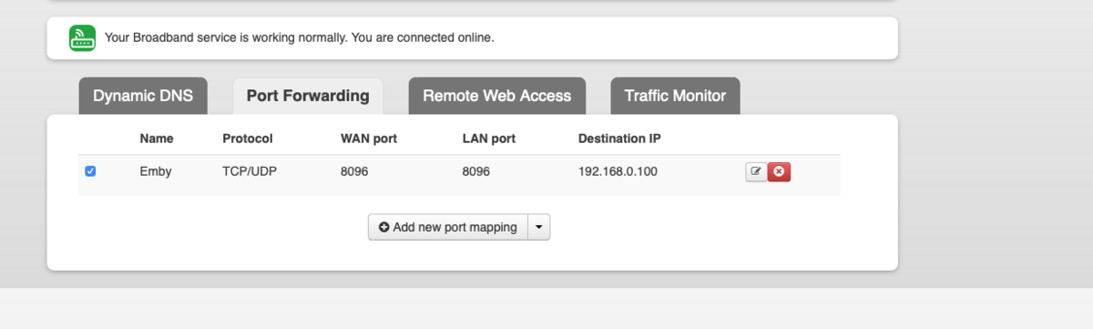

KLF&TLF 28 Posted January 29, 2022 Posted January 29, 2022 (edited) @cayarsI have tried this and played with my Destination IP address as my router is the 192 but when I go to Can you see me it tells me my IP is different and I have used that IP as well to test. Sometimes I really hate technology I am a complete idiot here as neither yours @cayars or @seanbuffare working. I want to kill telstra as they are useless. OK so what I have tried just now and neither option is working. I have tried it together and separately. Can you see me can't see me but thought I would double check by using my phone on data to test and same results. These are all the relevant screenshots: Do I need IP address in Emby network? (Sometimes I feel so dumb when this is really simple) Edited January 29, 2022 by KLF&TLF
seanbuff 1353 Posted January 29, 2022 Posted January 29, 2022 @KLF&TLF as per this article (https://support.emby.media/support/solutions/articles/44001849007-connectivity) What IP Address does your Emby dashboard show you for "In-Home (LAN) Access" ? That is the address that needs to go in the 'Destination IP' of your forwarding rule 1
KLF&TLF 28 Posted January 29, 2022 Posted January 29, 2022 (edited) Thanks @seanbuffI think that has done it. I have tested on my phones data and I am able to play so now I am getting someone to try 500ks away. BUT THANK YOU for all your assistance on a Saturday afternoon (hopefully your not isolating like I am) Spoke to soon, now without changing anything its not working again so going to give it a few hours to potentially populate as the hamster is sleeping at Telstra this afternoon Edited January 29, 2022 by KLF&TLF
Carlo 4561 Posted January 29, 2022 Posted January 29, 2022 2 hours ago, KLF&TLF said: @cayarsI have tried this and played with my Destination IP address as my router is the 192 but when I go to Can you see me it tells me my IP is different and I have used that IP as well to test. Sometimes I really hate technology I am a complete idiot here as neither yours @cayars or @seanbuffare working. I want to kill telstra as they are useless. OK so what I have tried just now and neither option is working. I have tried it together and separately. Can you see me can't see me but thought I would double check by using my phone on data to test and same results. These are all the relevant screenshots: Do I need IP address in Emby network? (Sometimes I feel so dumb when this is really simple) For now turn off UPnP in the router as well as NAY-PMP Enabled and save that. In Emby go to network menu and search for "Enable automatic port mapping" option. Make sure it is disabled here as well. Now go to the Dashboard and it should give you the local IP address. What is it? It will most likely start with 192.168.0.? This is your Emby and possibly Plex media server IP (if running on the same machine). This IP should never change but stay the same. We can see from above it's had a few different IPs. You will want to find an IP address on your network that isn't in use. You could open a command prompt (windows key R, then type cmd) to get a command prompt. Now type "ping 192.168.0.2". If it fails that means nothing is using that address. If you get response times back repeat with ping 192.168.0.3 and work you way up the numbers. Now once you've found an unused IP address we want to go back to the router. Find the configuration section to set private or reserved IP addresses for IPv4. Then most likely you will have a screen where you can pick the computer by name and manually assign it the IP from above. Once that's done you will need to either pull the ethernet cable for a couple of seconds and put it back in or you could just restart the computer. When it restarts load up Emby and make sure it has this new IP address. Now we know we won't have an IP that's changing inside your network for the media server. You can now try reconfiguring the IP Forwarding by editing the existing records to make sure they use this new address. Once more test at www.canyouseeme.com and see if you get a success. Let us know how you make out. If you're still have problems, hove your mouse over my profile pic and choose messages on the popup box to send me a message. We can setup a remote session and I can help you with this. Carlo 1
