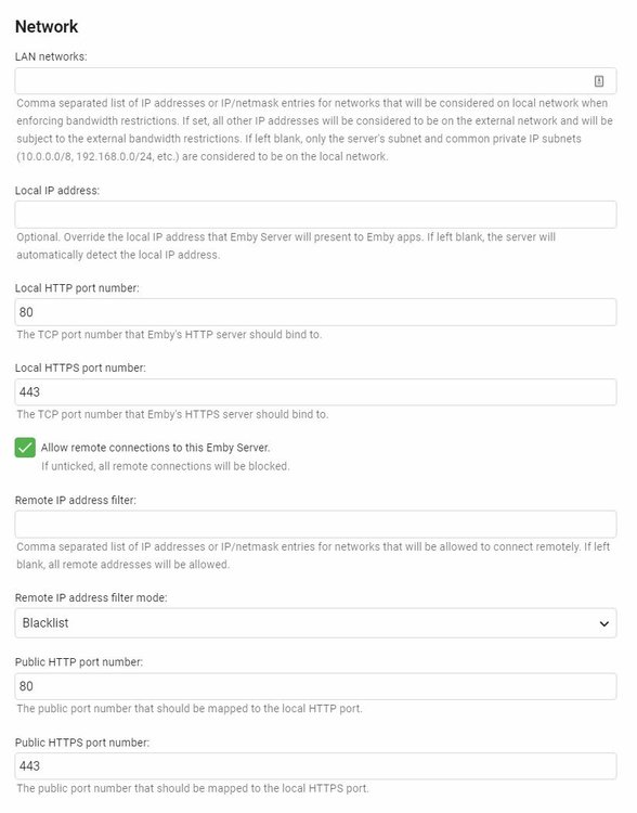

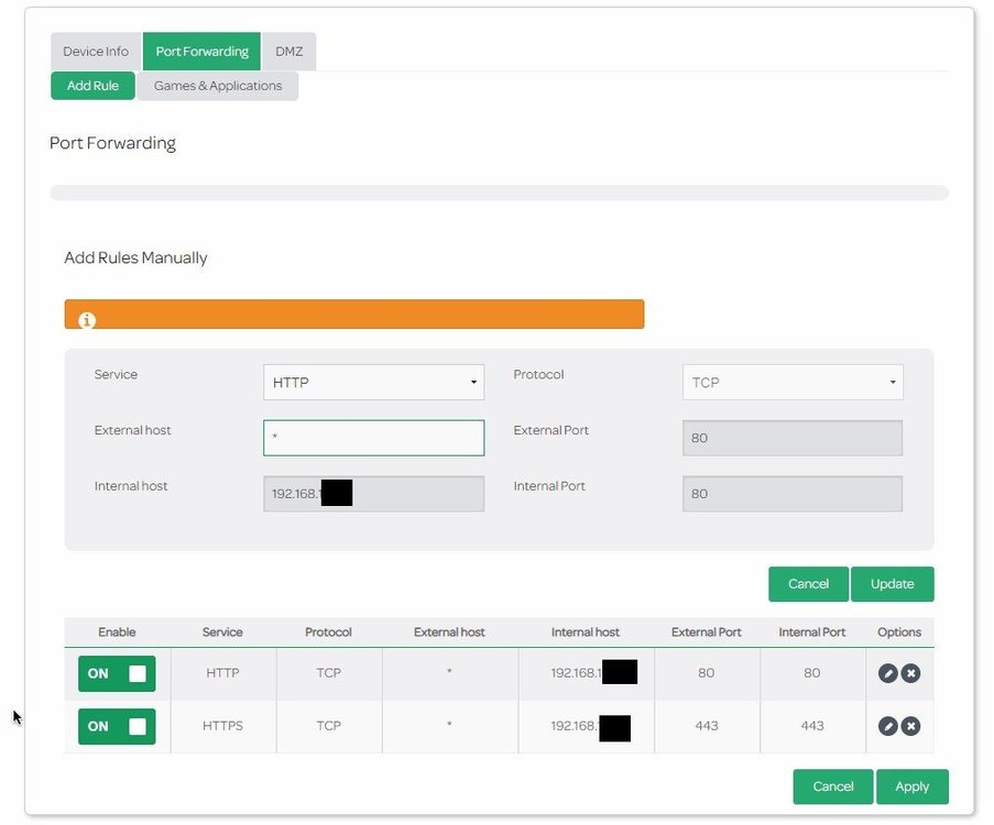

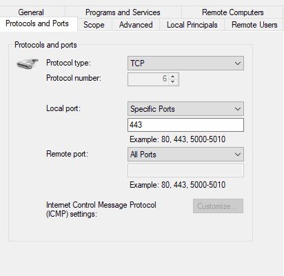

TurnerJo 0 Posted February 27, 2021 Posted February 27, 2021 Hello Everyone, The issue im having is i cannot access my emby server remotely. I can acces it via local ip address and on localhost. I have looked through the logs (see attached) and can see there is an issue with uPNP. so i have done the following as the emby guide says: 1) Manually added ports 80/443 to my routers port forwarding page. 2) Allowed ports 80/443 to be open on windows firewall and allowed embyserver program through as well. 3) Checked DDNS service and no problems with that 4) Tried using DDNS url and manually using public IP address and both just time out. Please can anyone point me in the right direction Many thanks embyserver.txt

Sammy 791 Posted February 27, 2021 Posted February 27, 2021 (edited) Local http port should be 8096 Local https port should be 8920 Remote http port should be 8096 Remote https port should be 443 You also need an external domain name, a valid ssl certificate and a ddns server. @cayars should be able to get you sorted. Edited February 27, 2021 by Sammy
GrimReaper 4927 Posted February 27, 2021 Posted February 27, 2021 8 hours ago, TurnerJo said: so i have done the following as the emby guide says: 1) Manually added ports 80/443 to my routers port forwarding page. I seriously doubt that the guide recommends using those ports...
Carlo 4561 Posted February 27, 2021 Posted February 27, 2021 50 minutes ago, GrimReaper76 said: I seriously doubt that the guide recommends using those ports... What ports you choose to use are up to you but 80/443 or just 443 is likely the best choice. Any browser will use these two port as the default. These two ports will work with any proxy or CDN service like Cloudflare that Emby default ports will not. If using Alexa or Google Home and want to playback audio on the device itself 443 is a great choice. In an update to Remote Setup that will cover some advanced topics these will be used as the default ports as they have advantages other ports don't have. I agree with everything Sammy said above except the DDNS which you don't want with SSL but want a domain you control instead. So DDNS or Domain & SSL. 1
GrimReaper 4927 Posted February 27, 2021 Posted February 27, 2021 4 hours ago, cayars said: What ports you choose to use are up to you but 80/443 or just 443 is likely the best choice. Any browser will use these two port as the default. These two ports will work with any proxy or CDN service like Cloudflare that Emby default ports will not. If using Alexa or Google Home and want to playback audio on the device itself 443 is a great choice. In an update to Remote Setup that will cover some advanced topics these will be used as the default ports as they have advantages other ports don't have. I agree with everything Sammy said above except the DDNS which you don't want with SSL but want a domain you control instead. So DDNS or Domain & SSL. I actually always avoided 80 due to envisioning a lot of traffic going back and forth there, both outgoing and incoming requests, thinkin' it MIGHT create some time-out issues occasionally if used. Nice to learn it ain't so.
Carlo 4561 Posted February 27, 2021 Posted February 27, 2021 Nah, nothing to worry about on that front. Your router will take care of all of that. Think about it. Do you think you can't run a webserver or two in a small company along with 50 people all using ports 80 and 443 all day long. The major advantage in general is http = port 80 and https = port 443 when no ports are specified in URs. That makes it easy to just type your domain name in a browser and boom, Emby loads. The downside to this as always is using KNOWN ports makes your server an easier target to identify via any remote port scan and port 80 is a default port to scan. If you switched ports to something random in the correct range then it's slightly harder to find this way as it won't show up in a scan only checking common ports but anyone doing a scan of all ports would stll find it. Well worth the trade off IMHO. But as always there is no right or wrong way to set this up. 1
TurnerJo 0 Posted February 27, 2021 Author Posted February 27, 2021 6 hours ago, Sammy said: Local http port should be 8096 Local https port should be 8920 Remote http port should be 8096 Remote https port should be 443 You also need an external domain name, a valid ssl certificate and a ddns server. @cayars should be able to get you sorted. The reason I used 80/443 is that is my routers default for http and HTTPS traffic. I have tried with those ports and no luck, same issue. I do have a external domain and valid SSL certificate and ddns, all three are working as intended so there's no issue there. The SSL certificate hasn't expired, the ddns has just been renewed and the domain points to the ddns Any other suggestions?
TurnerJo 0 Posted February 27, 2021 Author Posted February 27, 2021 1 hour ago, cayars said: What ports you choose to use are up to you but 80/443 or just 443 is likely the best choice. Any browser will use these two port as the default. These two ports will work with any proxy or CDN service like Cloudflare that Emby default ports will not. If using Alexa or Google Home and want to playback audio on the device itself 443 is a great choice. In an update to Remote Setup that will cover some advanced topics these will be used as the default ports as they have advantages other ports don't have. I agree with everything Sammy said above except the DDNS which you don't want with SSL but want a domain you control instead. So DDNS or Domain & SSL. Thanks for the input however the reason I use both is that my isp is notorious for switching my IP address. I have recently moved house and this set up was working as intended before.

Solution TurnerJo 0 Posted February 27, 2021 Author Solution Posted February 27, 2021 Hello everyone so I managed to figure it out. I had to change my HTTPS port back to 443. Then manually add the HTTPS port forwarding in my router (as an 'other' service rather than a HTTPS service) but even though emby says to use TCP I had to set it to TCP/UDP not just TCP on its own.i don't know whether it's intended to be this way or if I'm just being stupid but it works now except I can't connect via the domain (probably something to do with my routers DNS now allowing to connect back on its self). And also emby is working as intended that if someone tries to connect via http it will re route them to HTTPS. Thank you all for your help

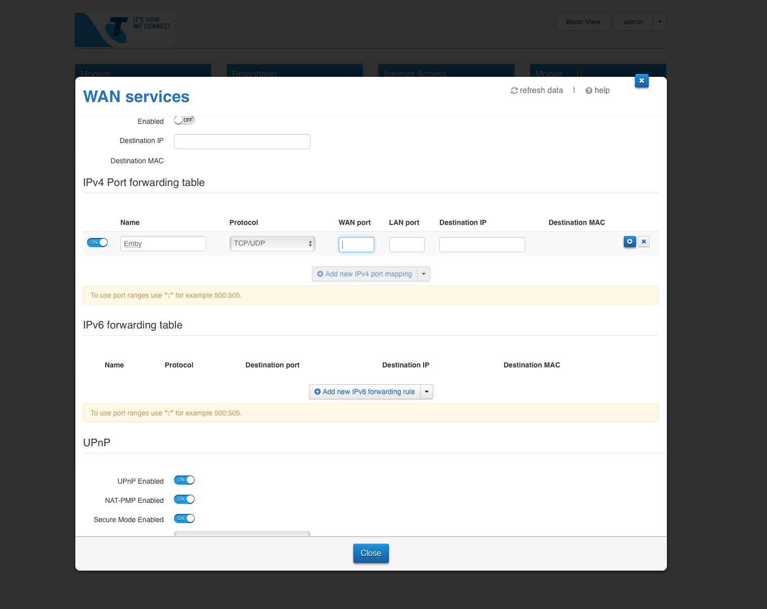

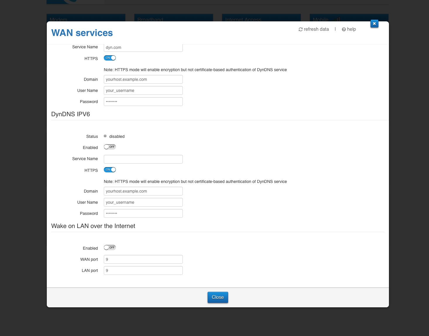

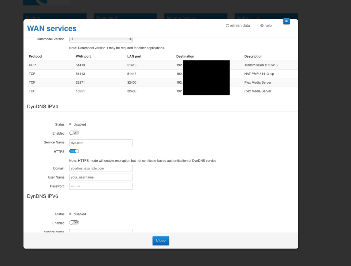

KLF&TLF 28 Posted January 27, 2022 Posted January 27, 2022 @cayarsHi, sorry to reengage this thread but I cannot seem to get mine to work at all and when I try the above I end up not being able to use Emby at all. In short my NBN provider (Telstra - in Australia) won't give me basic assistance and the router configure options don't seem to line up with what I need to do. I have attached the screenshots for my Port forwarding screen so any assistance would be greatly appreciated. As you can see I use to use Plex but found that Emby goes a little bit further. Thanks in advance
Carlo 4561 Posted January 27, 2022 Posted January 27, 2022 Wrong section of router. Set those setting back to defaults as you don't want to set route tables or routing. Instead you want normal routing/switching with port FORWARDING. You only want to forward port 8096 or 8920 to the Emby Server machine. Which router is that? Looks familiar.
KLF&TLF 28 Posted January 28, 2022 Posted January 28, 2022 @cayars The router is a Gen 2 Telstra Smart Modem and the config page is really funky. This is where I was when I first started this quest and in the process I locked myself out even when I was at home so deleted it all and threw my hands up in air. Now I have to go to hospital so want to take Emby with me so need to figure it out so I can watch both at home and while I am away. This is the screen I added the 8096 into and then changed it to 8920 and I couldn't access Emby on anything other than the machine that controls the libraries. If you can tell me what needs to be in these fields I will try again and see if I can succeed. Thanks in advance
