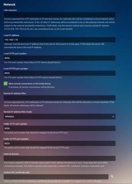

danpol 12 Posted February 23, 2021 Posted February 23, 2021 (edited) Why have i got no local access on dashboard Edited February 24, 2021 by ebr Removed sensitive info
Carlo 4561 Posted February 24, 2021 Posted February 24, 2021 Can you show up a picture of all options on your NETWORK menu page?
danpol 12 Posted February 24, 2021 Author Posted February 24, 2021 Here's a snippet from network folder
rbjtech 5337 Posted February 24, 2021 Posted February 24, 2021 And your emby IP address is 192.168.1.10 correct ? Is there a reason you entered this and did not leave it blank ? Providing your embyserver.txt log file may provide more insight into why it is not binding to your local LAN IP.
danpol 12 Posted February 24, 2021 Author Posted February 24, 2021 is it supposed to be blank i have embyserver txt lof file attached embyserver.txt
Carlo 4561 Posted February 24, 2021 Posted February 24, 2021 1 hour ago, rbjtech said: And your emby IP address is 192.168.1.10 correct ? Is there a reason you entered this and did not leave it blank ? Providing your embyserver.txt log file may provide more insight into why it is not binding to your local LAN IP. That's my guess as well. If you put in an IP address that no longer exists you can experience exactly what your dashboard is showing. Remove that address and restart Emby Server and see if it finds/binds to a different address.
rbjtech 5337 Posted February 24, 2021 Posted February 24, 2021 Looking at the logs - your clients are on a 192.168.0.0/24 network - meaning the IP you have added is likely not even on the same network .. I would remove it, restart emby and - it should then show a 192.168.0.x address. 1
