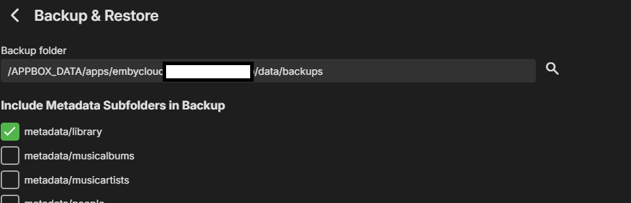

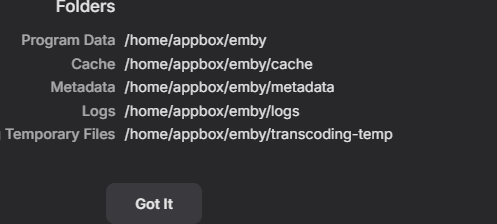

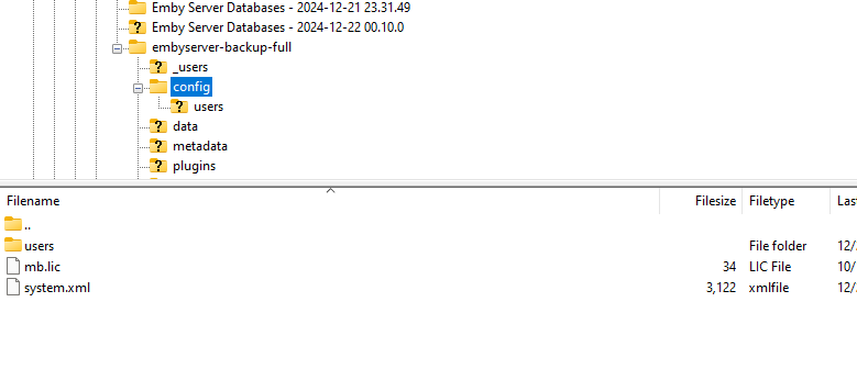

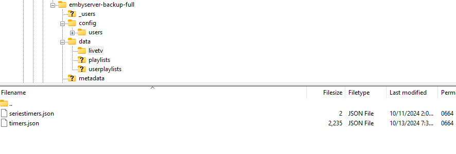

Ok ive read this a couple times and went to the config backup section you've linked. Still not finding this LIVETV.XML that is supposed to be there. any additional tips are appreciated. I have 2 emby servers and i really dont wanna have to manually redo these channels. thanks.
backupFolder.png.b70bddd42c3110c00ba55fcad77272ce.pngbackups.png.8e0fb41bcebcf38b8f21a46f5fc5e757.pngConfigFolder.png.f0480c4d569f735b5896ccb7c1dc6f3f.pngFolders.png.ae3a041ac4e4613b19d08a03f6f66b9e.pngliveTV_Folder.png.587845de8bfc4fcd457d89395243c435.png
Hi that’s in the database now so you’ll need to follow our backup guide:
Configuration Backup
 live TV settings will be included as part of  that.
ive read the backup guide and obv i am not seeing how to pull out just the LIVETV config data. I dont see ANYTHING in the Configuration BAckup guide page that mentions it. Am i missing something obvious
HI, sorry, there is no way to just pull live tv settings. It's not so simple when there is data that integrates with the libraries and users.
