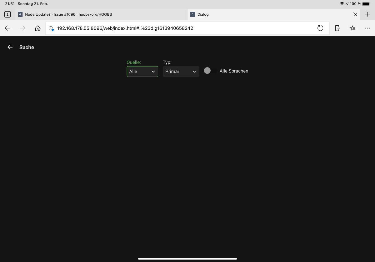

mikeB2210 26 Posted February 21, 2021 Posted February 21, 2021 Hi, after a long time I add some movies and series to my Server Version 4.5.4.0. I must recognize that my movies were not saved with the corresponding covers and tags. When I try to perform a search manually it seems as if no connection to the corresponding servers can be established. I cannot install or update any plugins either. I don't know if it has something to do with the fact that I changed the IP address of my OMV server beforehand. Any advice? embyserver-63749542939.txt hardware_detection-63749542946.txt
