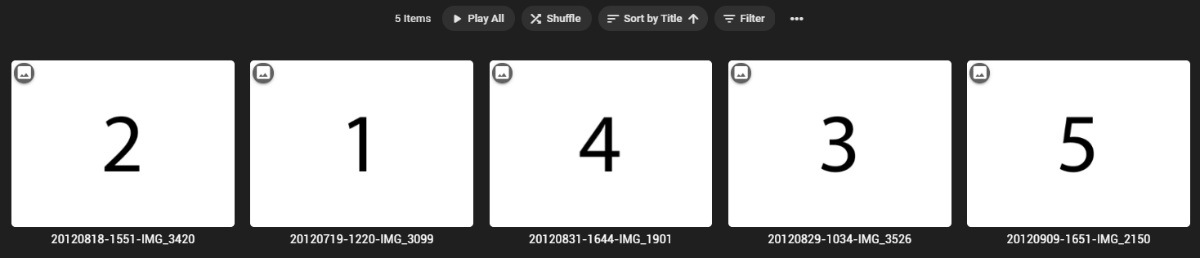

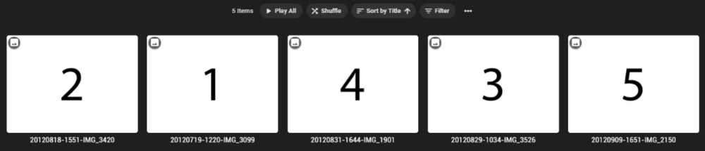

happpyg 20 Posted February 21, 2021 Posted February 21, 2021 Hi, I am almost positive this used to work previously but I'm finding my photos when sorting by title are not sorting correctly - well not sorting as I remember and how Windows sorts them. I name all my photos in this format yyyymmdd-hhmm-<original_photo_name> so that when I view them no matter what the date created/taken etc is or if I combine photos from multiple sources I know if I arrange by name/title they will be in the correct order. I've tried in Emby Web and Android clients, they are all consistent but not in the same order I remember and the correct order windows shows them in. Am I missing something or is Emby somehow sorting by another method or is sort by title broken somehow? Copy of samples attached, they display 1-5 in windows but not in Emby. Emby Windows Thanks! Sample_photos.zip

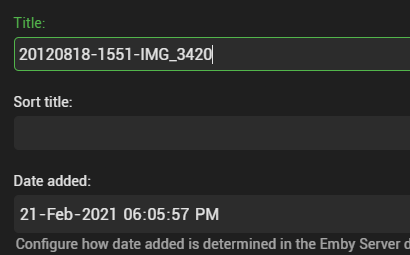

Luke 42271 Posted February 21, 2021 Posted February 21, 2021 HI, i would use the metadata editor to check the sort title of each one. If you've customized the sort title, try blanking it out and then clicking save.
happpyg 20 Posted February 22, 2021 Author Posted February 22, 2021 15 hours ago, Luke said: HI, i would use the metadata editor to check the sort title of each one. If you've customized the sort title, try blanking it out and then clicking save. Thanks Luke, Sort title is already blank. I have over 80,000 photos and I don't use custom sort titles on any of them. This test was 5 new .jpg's and I just used the names from other photos that weren't in the right order and added them to the library so see if that worked which produced the results above.

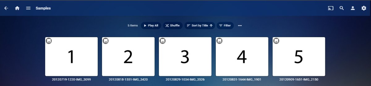

Happy2Play 9814 Posted February 22, 2021 Posted February 22, 2021 I just added the samples above to my 4.5.4.0 and 4.6.0.26 Windows test servers and both appear in correct order.
happpyg 20 Posted February 22, 2021 Author Posted February 22, 2021 1 hour ago, Happy2Play said: I just added the samples above to my 4.5.4.0 and 4.6.0.26 Windows test servers and both appear in correct order. I just tried the same and you are right. What could I be missing on my install/config, why the difference? You can see from my original screenshot it is definitely set to sort by title yet with the same test media I get different results? Thanks for testing!

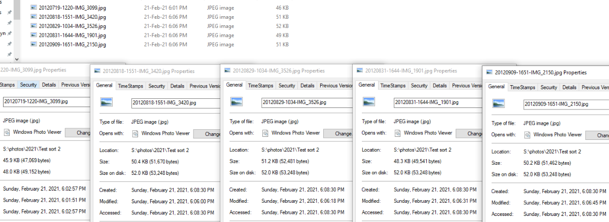

Carlo 4561 Posted February 24, 2021 Posted February 24, 2021 Nope. Can you take a screen shot of the files on disc? I really want to see the file dates.
happpyg 20 Posted February 25, 2021 Author Posted February 25, 2021 9 hours ago, cayars said: Nope. Can you take a screen shot of the files on disc? I really want to see the file dates. Thanks, is this what you are after?

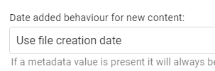

Carlo 4561 Posted February 25, 2021 Posted February 25, 2021 What do you have set for Library->Advanced Tab->Date added behavior for new content: ?
happpyg 20 Posted February 25, 2021 Author Posted February 25, 2021 11 hours ago, cayars said: What do you have set for Library->Advanced Tab->Date added behavior for new content: ? Currently set to "Use file creation date". Thanks for your help!
Happy2Play 9814 Posted February 25, 2021 Posted February 25, 2021 11 hours ago, cayars said: What do you have set for Library->Advanced Tab->Date added behavior for new content: ? But that should be irrelevant unless sorting by Dateadded. But those files sort by dataadded properly for me also. I guess if you created a new test library and placed these items in it do you get the same results? @happpyg

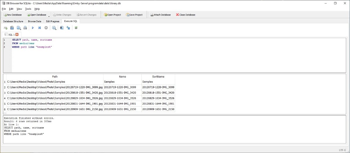

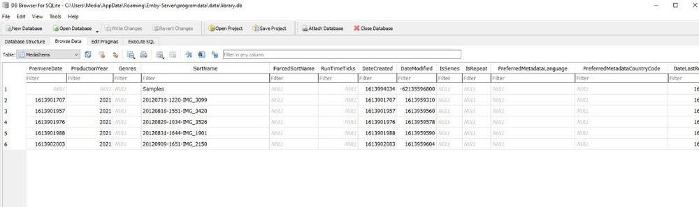

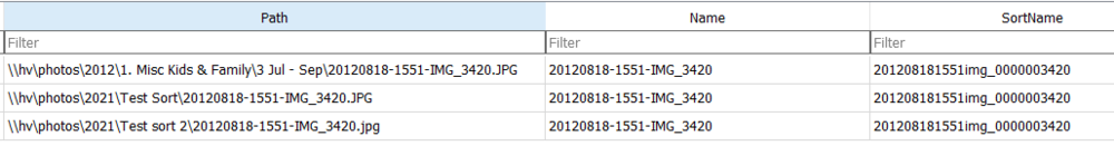

Happy2Play 9814 Posted February 26, 2021 Posted February 26, 2021 (edited) 11 minutes ago, happpyg said: Thanks Happy2Play, this is the bit that is confusing. The exact same test media above in a new/clean install of 4.5.4 works perfectly yet in my existing 4.5.4 install the same test files don't sort correctly, make a new folder drop them in, let the library scan/add and they are not sorted correctly, weird? One thing you could check is if there is a difference in the library option.xml. Maybe the system.xml also. C:\Users\username\AppData\Roaming\Emby-Server\programdata\root\default\"your library name" C:\Users\username\AppData\Roaming\Emby-Server\programdata\config Only other thing I can suggest is making a copy of your library.db and look at that copy in a db viewer and look at the sortname listed for those items as I know there use to be bug here. presorted to these items via the Path column in Metaitems table Edited February 26, 2021 by Happy2Play

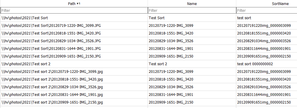

happpyg 20 Posted February 26, 2021 Author Posted February 26, 2021 20 minutes ago, Happy2Play said: One thing you could check is if there is a difference in the library option.xml. Maybe the system.xml also. C:\Users\username\AppData\Roaming\Emby-Server\programdata\root\default\"your library name" C:\Users\username\AppData\Roaming\Emby-Server\programdata\config Only other thing I can suggest is making a copy of your library.db and look at that copy in a db viewer and look at the sortname listed for those items as I know there use to be bug here. presorted to these items via the Path column in Metaitems table Thanks. Cant see anything out of the ordinary here?
Happy2Play 9814 Posted February 26, 2021 Posted February 26, 2021 Not sure as your sortnames are slightly different. Was thinking difference in stable vs beta, but I get the same results on both. Not sure if @Luke has any other ideas why the difference in name and sortname compared to mine. 1
