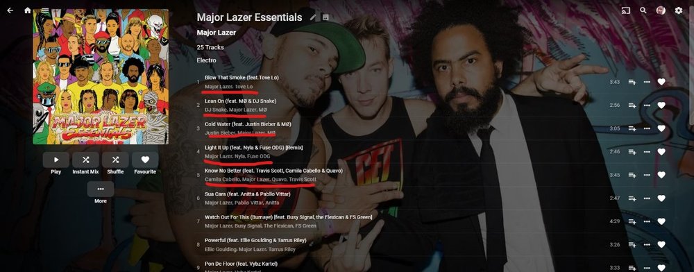

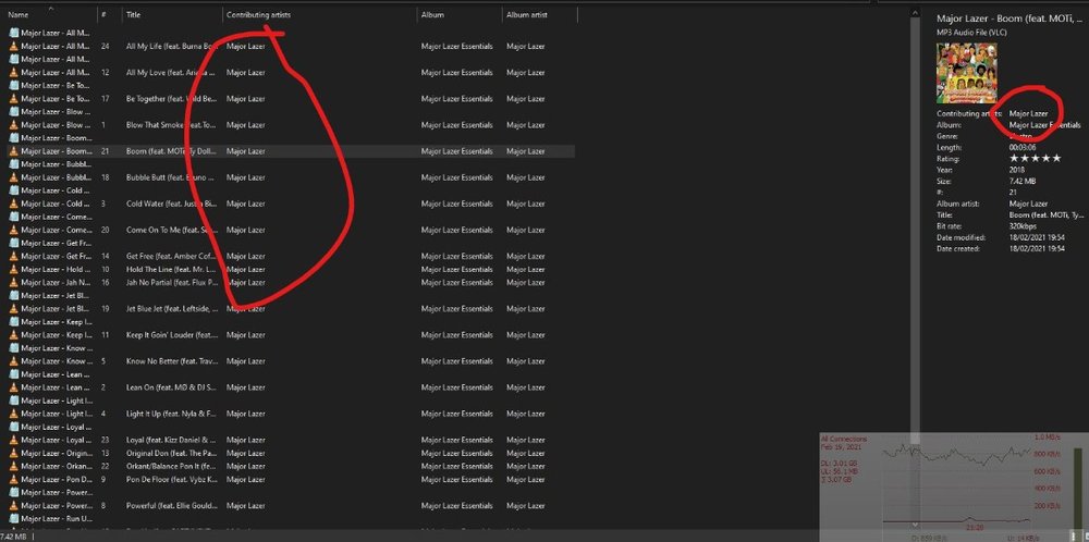

misterkoat 6 Posted February 19, 2021 Posted February 19, 2021 Normally what I do is, I get my music files from a streaming site and rip it with 100% correct tags. Music files have multiple artist tags and for consistency purposes, one usually keeps the main artist so that data sent to last fm for scrobbling across emby, kodi, spotify, deezer etc is similar. Previously i used to rip with all the artists and edit the files manually to leave the main artist only. no problems. Now, since I rip hundreds of songs at once, it's definitely a lot of work to edit each one of them manually and so i've set that the ripping software just keeps the main artist. From the Windows file explorer, this is how the files look. Pay attention to the marked areas From, say another audio app, which in this case is Groove Music this is how it looks Totally consistent right? However, this is Emby Where did the extra tags come from? I've scoured the files extensively yet can't seem to find any attribute of the file that even contains the tags. This started happening when I changed the option to remove all other secondary artists and leave the main artist. Kindly help.

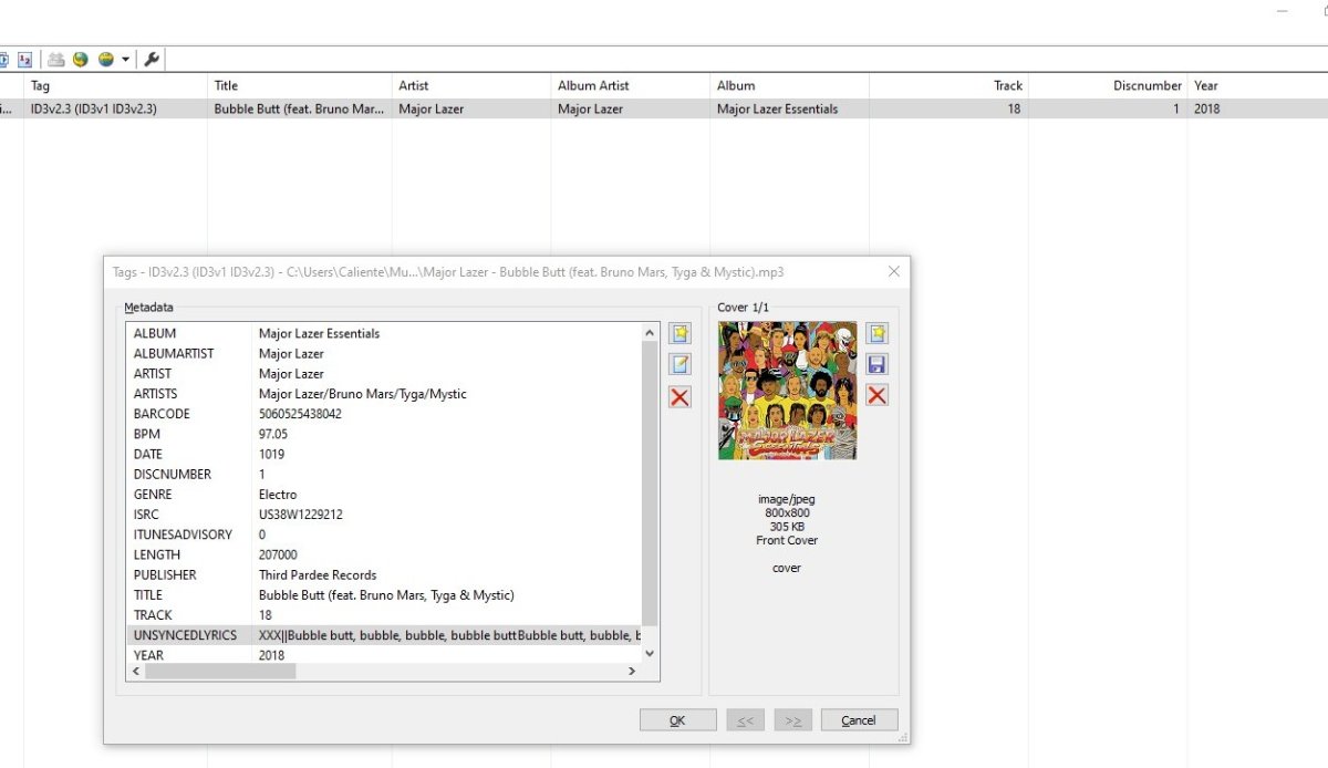

PenkethBoy 2068 Posted February 19, 2021 Posted February 19, 2021 open them in mp3Tag (use alt+T to see every tag) and you can see all the tags - audio progs dont always show all the tags 1
Luke 42204 Posted February 20, 2021 Posted February 20, 2021 Penkethboy is exactly right. I promise you'll find those values embedded within your audio files. The server isn't making them up or pulling them from any internet source.

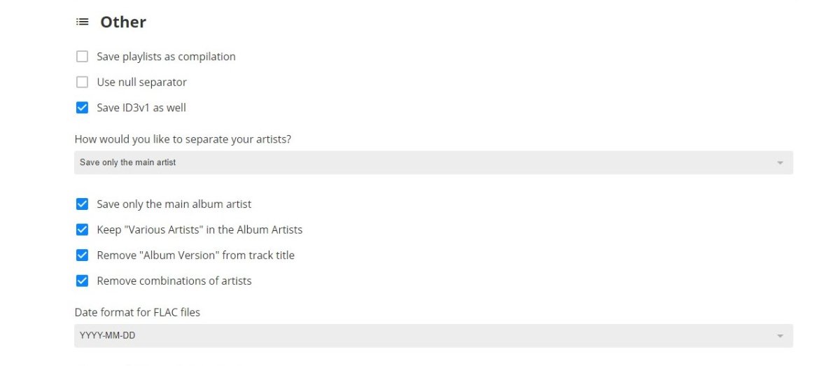

misterkoat 6 Posted February 20, 2021 Author Posted February 20, 2021 I've seen them after opening using Mp3Tag. However still, there's a problem. I honestly never knew that there was an mp3 field called artists, apart from contributing artists and album artist. It would be much simpler if emby stuck with the regular fields that audio players use to read audio tags. Even though I now know where the tags are coming from, editing all the files to remove that field is still alot of work. These are the only options available in the ripping software and I've tried all of them to no sucess in removing the field. Is this an issue that can be fixed in the next update? And while at it, emby can't read "year" tag. Could it be because I use ID3v1 and ID3v2?

misterkoat 6 Posted February 20, 2021 Author Posted February 20, 2021 2 minutes ago, PenkethBoy said: then you are going to have issues or not. I've decided to fix the issue from the software side so let's see how that plays out.
