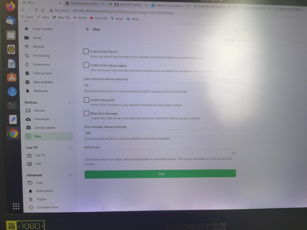

Luke 42246 Posted February 20, 2021 Posted February 20, 2021 Hi, there's an error in this log that I haven't seen before, but it should be easy enough to trap and fix for the next release. In the meantime, for immediate relief, simply disable all of the server's dlna features, then restart it. If you need Dlna features, I'll have the fix in the next beta server. Thanks.
tokyohoo 0 Posted February 20, 2021 Author Posted February 20, 2021 8 minutes ago, Luke said: Hi, there's an error in this log that I haven't seen before, but it should be easy enough to trap and fix for the next release. In the meantime, for immediate relief, simply disable all of the server's dlna features, then restart it. If you need Dlna features, I'll have the fix in the next beta server. Thanks. Thanks for the effort looking into my logs. I didn't install Dlna service yet. This today logs is base on fresh install. Even didn't set up homepage configuration yet too. I will still trying to find a way to solve. As this debian Deb at download site works very well in my another debian 8 jeisse Nas.
Luke 42246 Posted February 20, 2021 Posted February 20, 2021 Dlna is enabled by default. you can turn it off in emby server settings.

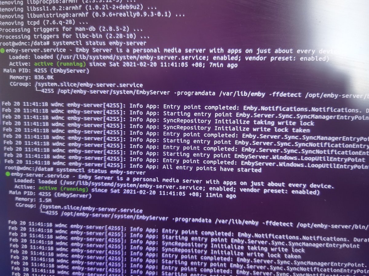

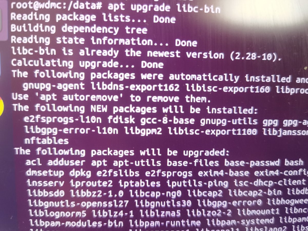

tokyohoo 0 Posted February 20, 2021 Author Posted February 20, 2021 18 minutes ago, Luke said: Dlna is enabled by default. you can turn it off in emby server settings. I did apt upgrade of libc-bin(2.28-10) which I saw command line Processing triggers for libc-bin (2.28-10) During the dpkg - i emby. Deb. After a bunch of stuff upgraded together. With your Dlna settings turned off. Service keep on about 25mins till now.hope can see longer result.

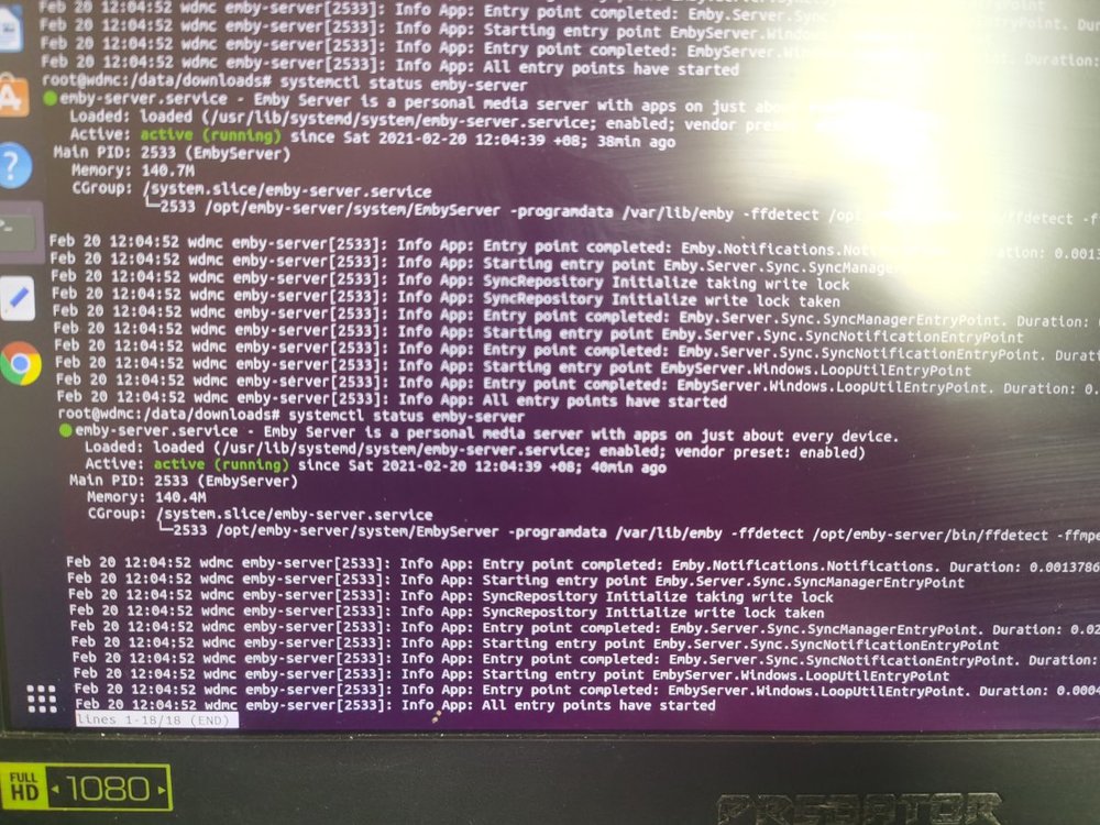

tokyohoo 0 Posted February 20, 2021 Author Posted February 20, 2021 38 minutes ago, Luke said: Dlna is enabled by default. you can turn it off in emby server settings. I would try one more round fresh install debian 9 and emby again with your method. Because after I upgrade the libc-bin. Emby memory usage increase from 1.7mb to 140mb. It even works as memory low as 830K. Is it because of this crashing emby every about 15mins?or doesn't matter. As long as turned off Dlna.
Luke 42246 Posted February 20, 2021 Posted February 20, 2021 140mb is not that much. Are you still having a problem?
