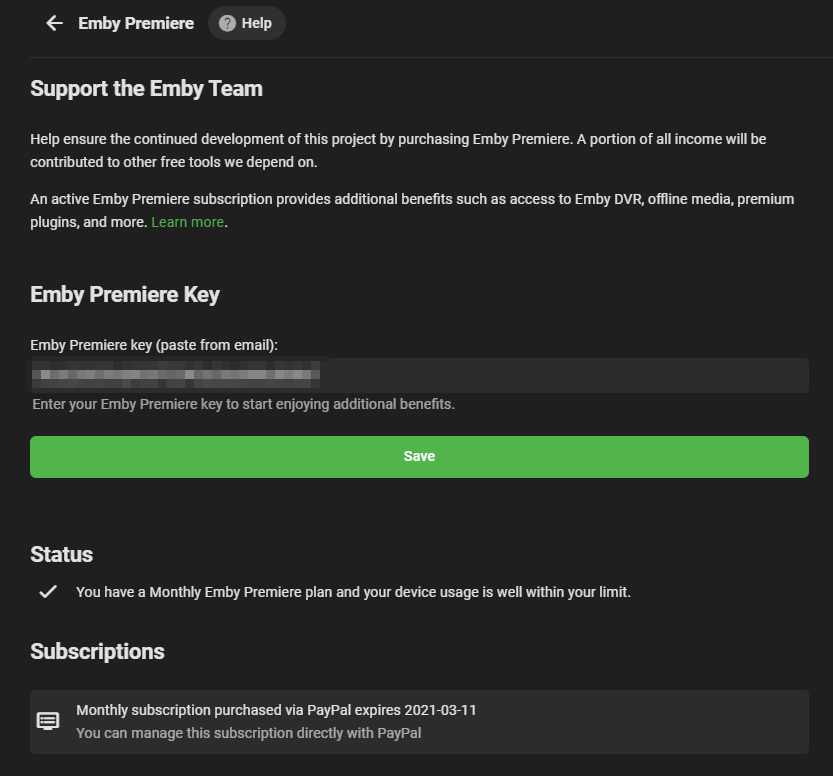

Carlo 4561 Posted February 17, 2021 Posted February 17, 2021 I know you said you input your Premiere Key. But what does the status show for it? I'd be happy to do a remote session with you to take a look and see if I notice anything or try a couple of things. Send me a PM if you want to set this up.
BenVenn 22 Posted February 17, 2021 Author Posted February 17, 2021 1 minute ago, cayars said: I know you said you input your Premiere Key. But what does the status show for it? I'd be happy to do a remote session with you to take a look and see if I notice anything or try a couple of things. Send me a PM if you want to set this up. Hi cayars, Emby Premiere is showing as active. I'd be happy to have a remote session. I'll send you a private message now. Thanks 1
