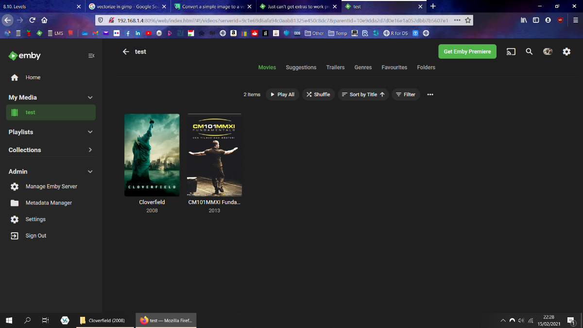

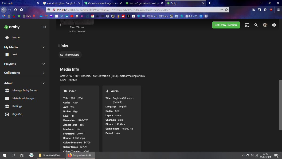

UltraDave9000 0 Posted February 15, 2021 Posted February 15, 2021 (edited) Evening, Firstly I should say I've searched all over to try and solve this, to no avail. I am setting up Emby Server on a Raspberry Pi for a small home network; I am new both to the Pi (and indeed Linux) and Emby. All has been straightforward enough with the exception of the handling of movie extras. I just can't get them to register as extras; they come up as individual movies with random attempts to match metadata to the titles I am using a Pi 3b+ with Version 4.6.0.22 beta. I am testing the result on a windows laptop via Firefox. The library type is Movies. The source files are on a old ReadyNAS Ultra 4+; Pi and NAS are connected via rj45 and a switch. I have followed the naming convention and every variation I can think off. I have removed libraries and re-added them countless times. I've rebooted the pi; I've even uninstalled and re-installed Emby Server. Structures I have tried include the most obvious : /Cloverfield (2008) /Cloverfield (2008)/Cloverfield (2008).mkv /Cloverfield (2008)folder.jpg [for the thumbnail image, a hangover from previous DLNA use] /Cloverfield (2008)/extras /Cloverfield (2008)/extras/deleted scenes.mkv Originally I thought multiple extras was no good; I have removed all but one in a test library - no bananas. I have tried /specials instead of /extras. I have tried /Extras and /extras. I have tried: /Cloverfield (2008) /Cloverfield (2008)/Cloverfield (2008).mkv /Cloverfield (2008)/Cloverfield (2008) - deleted scenes.mkv [just comes up as a movie variant as you would expect] I've also done /Cloverfield (2008)/extras/Cloverfield (2008) -extras01.mkv Still not a sausage of an extra on the movie page, just some random additional movie based on a tenuous title match. I've tried other random variations too. Each time I've removed the library ad re-added it, to improve the chances (but just re-scanning has been tried and didn't help). I've tried refreshing metadata. I was using a fairly large library but to save time with all the frustrating testing I've removed everything and just tried to get a single movie working. I can't see any logical reason why one of the above variants shouldn't work and can't help thinking there must be some sort of bug or anomaly with my particular setup that is causing this. Can anyone help? Edited February 15, 2021 by UltraDave9000
roaku 842 Posted February 15, 2021 Posted February 15, 2021 (edited) You should be able to just put your extras files inside that 'extras' directory. Don't include the movie name/year for the filenames. Just a descriptive name for that particular extra. Same process for the other supported directory names, if you want to use any of them. Edited February 15, 2021 by roaku
UltraDave9000 0 Posted February 15, 2021 Author Posted February 15, 2021 4 minutes ago, roaku said: You should be able to just put your extras files inside that 'extras' directory. Don't include the movie name/year for the filenames. Just a descriptive name for that particular extra. Same process for the other supported directory names, if you want to use any of them. Thanks - yes, I've tried that - screenshots below show exactly that structure, still listed as a separate random movie.

Luke 42246 Posted February 17, 2021 Posted February 17, 2021 OK sorry I misread. My next suggestion would be, since you added windows unc share paths to emby server. Try instead mounting the network share to a local path on the server machine. Then add the local path into emby server instead of the unc share. I have a feeling this will resolve the issue.
UltraDave9000 0 Posted February 17, 2021 Author Posted February 17, 2021 2 minutes ago, Luke said: My next suggestion would be, since you added windows unc share paths to emby server. Try instead mounting the network share to a local path on the server machine. Then add the local path into emby server instead of the unc share. I have a feeling this will resolve the issue. Eeek, I am an absolute Pi/Linux newbie and I have no idea how to do this! Any clues?
Luke 42246 Posted February 17, 2021 Posted February 17, 2021 https://linuxize.com/post/how-to-mount-cifs-windows-share-on-linux/ If you're on Ubuntu they have more specific instructions: https://wiki.ubuntu.com/MountWindowsSharesPermanently
UltraDave9000 0 Posted February 17, 2021 Author Posted February 17, 2021 1 hour ago, speechles said: Yeah. You might have to move the folders out of the library. Scan library. Then move those folders back in. Scan library. That will remove the internal NFO if you do not save metadata with media. Tried this - didn't work, but thanks for the suggestion.
UltraDave9000 0 Posted February 17, 2021 Author Posted February 17, 2021 1 hour ago, Luke said: https://linuxize.com/post/how-to-mount-cifs-windows-share-on-linux/ If you're on Ubuntu they have more specific instructions: https://wiki.ubuntu.com/MountWindowsSharesPermanently Many thanks - will try this once I can build up the enthusiasm to spend some more time on this. The Emby client app on my Samsung TV keeps crashing so I'm losing the will to live, might just try an alternative like Plex.
Luke 42246 Posted February 17, 2021 Posted February 17, 2021 8 minutes ago, UltraDave9000 said: Many thanks - will try this once I can build up the enthusiasm to spend some more time on this. The Emby client app on my Samsung TV keeps crashing so I'm losing the will to live, might just try an alternative like Plex. Mounting shares is easy. Give it a try and there's a decent chance it will resolve both of your issues.
UltraDave9000 0 Posted February 17, 2021 Author Posted February 17, 2021 59 minutes ago, Luke said: Mounting shares is easy. Give it a try and there's a decent chance it will resolve both of your issues. Haha, thanks for the encouragement! I decided not to let it defeat me and have mounted the CIFS share on the pi. Took a bit of faffing, something to do with SMB version, who knows. And the extras are now working! You absolute legend; thanks for the help! Will have to test a bit more to see if the crashing stops, that's a job for tomorrow though. -Dave
