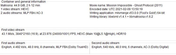

jangle 1 Posted February 14, 2021 Posted February 14, 2021 SERVER: 4.5.4.0 Windows Server 2019 Intel i5 3.4 / 64Gb RAM Nvidia GT710 Video with hardware transcoding enabled Good Evening, I have a stable server that has been running fine for months. I have introduced 4k content and finding the client requesting to transcode due to audio stream. I am struggling to understand why my client is request transcoding for the audio stream when the client supports AC3. I have included a copy of the transcode log which may hold the key. The film will play then start stuttering as the transcoding fails to keep up. Regards, Stuart ffmpeg-transcode-17bcf740-f779-4d6a-bb3c-be686834a0d6_1.txt

jangle 1 Posted February 14, 2021 Author Posted February 14, 2021 (edited) ebr, I just ran the process and no transcode required, this was after I had restarted the server in question. Which I found weird as AC3 was selected the same as before. I can see in my original transcode log AC3 being selected and and recoded as not compatible. However in this run I have to select True HD which was not supported and coding made sense. I am confused. I guess my first thought was hardware should support the video and audio types so no transcode required. My second thought was transcode is glitching as the speed is slow hence the playback was struggling do I need an upgrade. My third thought was it was playing for 80% of the film no issues then towards the end the audio cut out but the picture was fine, stopping and starting 3 times it eventually kicked in but then starting glitching and on review I was getting 1.1mbps transcode, hence this thread. I appreciate the transcoding hardware acceleration for GPU for Video but what handles audio stream? ffmpeg-remux-ab66c6d2-11df-470c-855a-2c6ccbc5cd91_1.txt Edited February 14, 2021 by jangle
