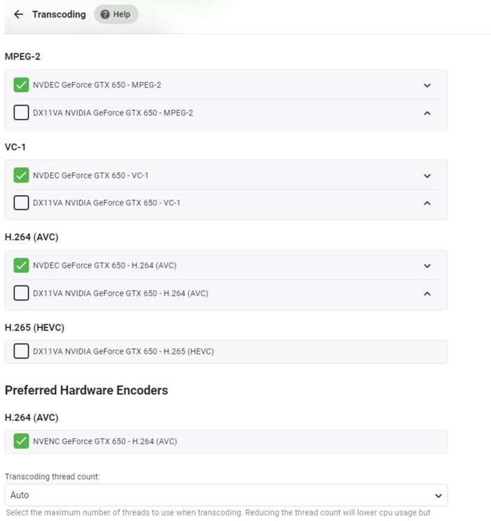

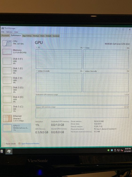

jesusvinatrujil 0 Posted February 14, 2021 Posted February 14, 2021 a few days ago I bought the Premiere code I also have the NVIDIA card drivers updated and configured in Transcoding. but when I play a movie it uses all the CPU, while the GPU is not used. can you help please.

Happy2Play 9802 Posted February 14, 2021 Posted February 14, 2021 Looking at the screenshot above there is a issue possibly Drivers as you do not have a encoder listed above. That is a legacy card but does have a h264 encoder. Had to use the WayBackMachine as Nvidia's new matrix no longer lists legacy cards. Video Encode and Decode GPU Support Matrix | NVIDIA Developer (archive.org) Dev will probably need to see the hardware_detection log also.

Happy2Play 9802 Posted February 14, 2021 Posted February 14, 2021 Don't know exactly what it means but hardware failed so it failed over to software/cpu. 17:03:22.360 [AVHWDeviceContext @ 000002a33108b700] Using D3D11 device 10de:0fc6 (NVIDIA GeForce GTX 650). 17:03:22.375 [AVHWDeviceContext @ 000002a33108b700] Failed to create Direct3D11 device (887a0004) 17:03:22.375 Device creation failed: -1313558101. 17:03:22.375 [h264 @ 000002a330accd00] No device available for decoder: device type d3d11va needed for codec h264. 17:03:22.375 Stream mapping: 17:03:22.375 Stream #0:0 (h264) -> subtitles (graph 0) 17:03:22.375 subtitles (graph 0) -> Stream #0:0 (libx264) 17:03:22.375 Stream #0:1 -> #0:1 (dts (dca) -> ac3 (native)) 17:03:22.375 Device setup failed for decoder on input stream #0:0 : Unknown error occurred
Solution pwhodges 2028 Posted February 14, 2021 Solution Posted February 14, 2021 (edited) Have you checked that you have the latest (last?) video driver for that device? The Windows-supplied driver is often not the best to rely on. The nVidia site can provide a checker, though whether it will check legacy boards I have no idea. Paul Edited February 14, 2021 by pwhodges
jesusvinatrujil 0 Posted February 15, 2021 Author Posted February 15, 2021 hi pwhodges I check again the driver as you recommend and make a clean installation, that change the driver and I think is working now. check please the file. thanks ffmpeg-transcode-78888cea-7b08-4766-9759-f5666c6c7cbc_1.txt
