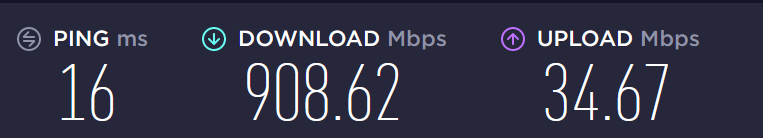

Happy2Play 9802 Posted February 11, 2021 Posted February 11, 2021 Only thing I can think of is a banwidth issue. What is your server upload speed? Isn't that a transcode log for something you played locally in Firefox?

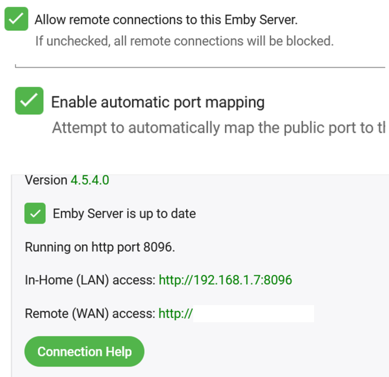

Carlo 4561 Posted February 11, 2021 Posted February 11, 2021 Hi, Just a quick question, have you setup your server so it works remotely? You have to enable remote use, otherwise it will only work on your own LAN. https://support.emby.media/support/solutions/articles/44002137137-remote-setup
nlcaragua5 4 Posted February 12, 2021 Author Posted February 12, 2021 (edited) Edited February 12, 2021 by Happy2Play Removed external address
Solution Happy2Play 9802 Posted February 12, 2021 Solution Posted February 12, 2021 Are you saying you had issues with the transcode log above as that is not a remote playback. Is there a transcode log for playing remotely on phone? But looking at the server log it would appear you are trying to play something at almost 30Mb on your phone. 021-02-11 15:38:06.787 Info App: RemoteClientBitrateLimit: 34750000, RemoteIp: xxx.xxx.xx.xxx, IsInLocalNetwork: False Playbackinfo MaxStreamingBitrate=30000000 VideoBitrate=29616000&AudioBitrate=384000 TranscodeReasons=AudioCodecNotSupported Transcode copying video and converting audio -c:v:0 copy -bsf:v:0 h264_mp4toannexb -c:a:0 ac3 -ab:a:0 384000 If you lower the in app quality do you still have issues?
