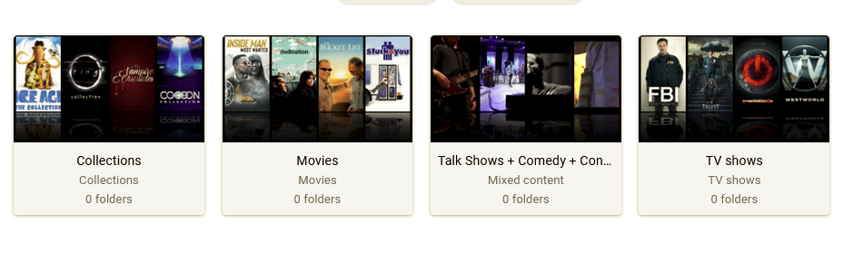

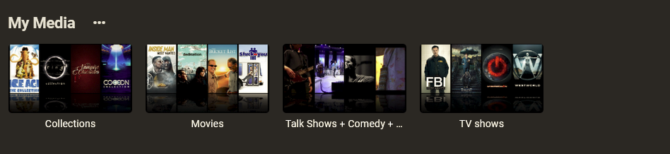

Garbonzo17 26 Posted February 12, 2021 Author Posted February 12, 2021 (edited) After all I have done I will just remake the users... There is only about 20 and most are cut/past setting (same adjustments), I read some thing about manually editing/merging with some sql commands, but honestly I have spent all day with it and this just seems easier. I had already tried copying just the config and plugin folders, plus the displaypreferences.db, user.db, and library.db only, on-top of a FRESH install exited before the setup-wizard. And like the images showed in the OP my media shows up in the web player and actually play, but when I looked in Library settings ALL of the libraries show 0 folders... so I didn't trust that going forward. While I am waiting for the importing to finish I really want to finsh setting up my AutoOrganize settings, but I am to chicken to restart the server until the media-scan completes... I know it "should" be ok, but people can just deal with it being down tonight... I am watching "his dark materials" on hbomax tonight anyway... Is there a plain text list of the usernames anywhere? in the old install config/users there are 21 folders (I assume each representing a user). Or can I open the old user.db in sql and query the names? I can handle the passwords in a standard/reset type situation, but I didn't do a screen-cap of the old users page. The frustrating part is that after doing the Windows 10 refresh/restore PC thing, everything was working except the new SSL. I assume that has something to do with it "technically" being a new install/IIS implementation. That seems reasonable. But redoing all of the Certify/IIS/export pfx steps didn't resolve it. But putting that SAME pfx file and password in place on a clean install and the SSL works as it should. Its frustrating not being able to figure out the actual problem (that is more frustrating to me that having to essentially start from scratch, that I can deal with.... I hate not figuring out the cause/fix) ** also, its only like 20% through the PEOPLE, am I safe canceling that and copying the old /ProgramData/metadata ?? that was what was recomended. The Scan Media is only at like 91% but from what I remember last year the ~88%-100% took FOREVER. Edited February 12, 2021 by Garbonzo17 question about "People"
