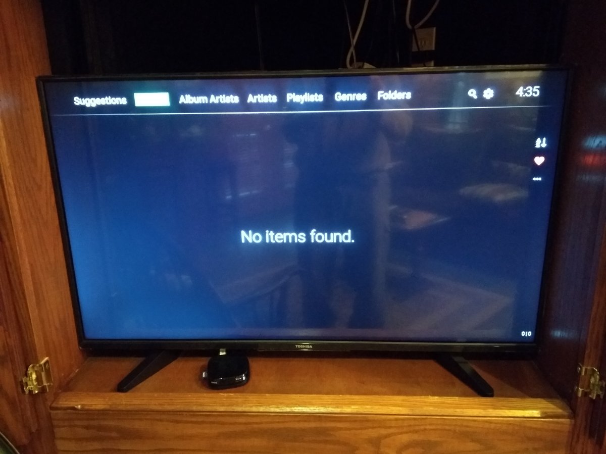

botbswco 5 Posted February 12, 2021 Author Posted February 12, 2021 Beta App does NOT populate on Albums, Album Artist and Artist tabs. Only change in behavior is that a large, center screen, message of "No Items Found", displays instead of just the 0/0 indication.
ebr 16335 Posted February 12, 2021 Posted February 12, 2021 Please bring up one of the tabs that is empty then immediately send a log from the app and also post the server log here from when you did that. Thanks.

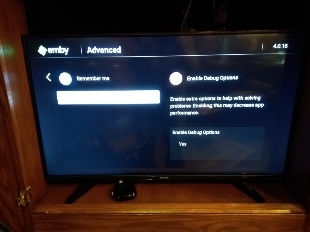

botbswco 5 Posted February 12, 2021 Author Posted February 12, 2021 Sorry, turned on dbug items but can't find where to send log. Please see attached pics.
botbswco 5 Posted February 12, 2021 Author Posted February 12, 2021 To be clear, after turning on the debug options, I exited the app and then went back in. I did not reboot the roku.

speechles 2062 Posted February 12, 2021 Posted February 12, 2021 (edited) You need to press Down once then press Right once. You will land on the toolbar ribbon. Unselect the heart. You have constrained the view to just favorites. We need to explain this better on that screen that the view is constrained and because of that it limits what is shown and may show nothing. These views are remembered. So if you leave it on and expect next time it will unselect or go back to default this will not happen. You must unselect it yourself. The remembering of views is a feature. Each library type can have a different view. The grid views are not reset on entry they are loaded back from last entry. Edited February 12, 2021 by speechles
speechles 2062 Posted February 13, 2021 Posted February 13, 2021 @botbswco Apologies for the problem. We will do something to make this much more clear that the reason there are no items is because the user has set options that produce no results. If those options were changed the results would then appear. Thanks for showing us where we need to improve things. ^_~
ebr 16335 Posted February 13, 2021 Posted February 13, 2021 Good eye speechles. OP - the fact the heard was red was supposed to be an indicator that it is engaged. We will find a way to make this more obvious. We don't need it now but, for sending the logs, scroll to the bottom of your home screen.
