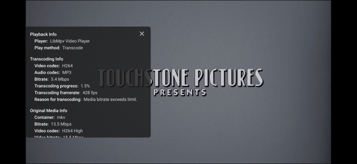

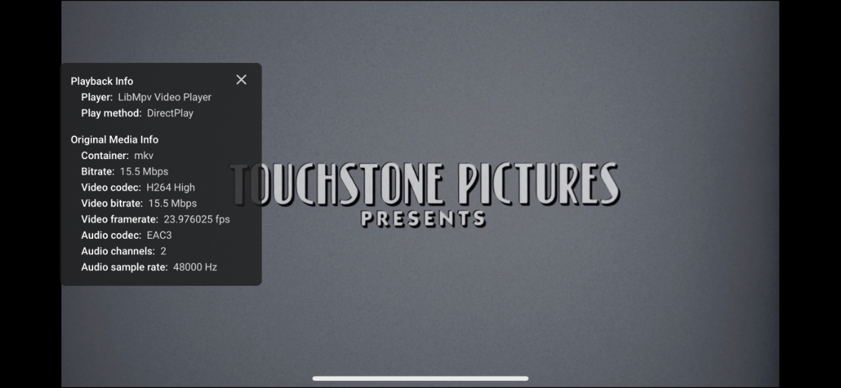

Jcheinaman 19 Posted February 10, 2021 Author Posted February 10, 2021 This is so weird. I turned on express VPN on my phone on my cell network and it transcoded and respected the 5 mbps limit. I turned the VPN off and it started playing at 15.5 mbps again. Top picture has express VPN turned on my phone and the bottom is with the VPN off. Both on cellular data on the T-Mobile network.

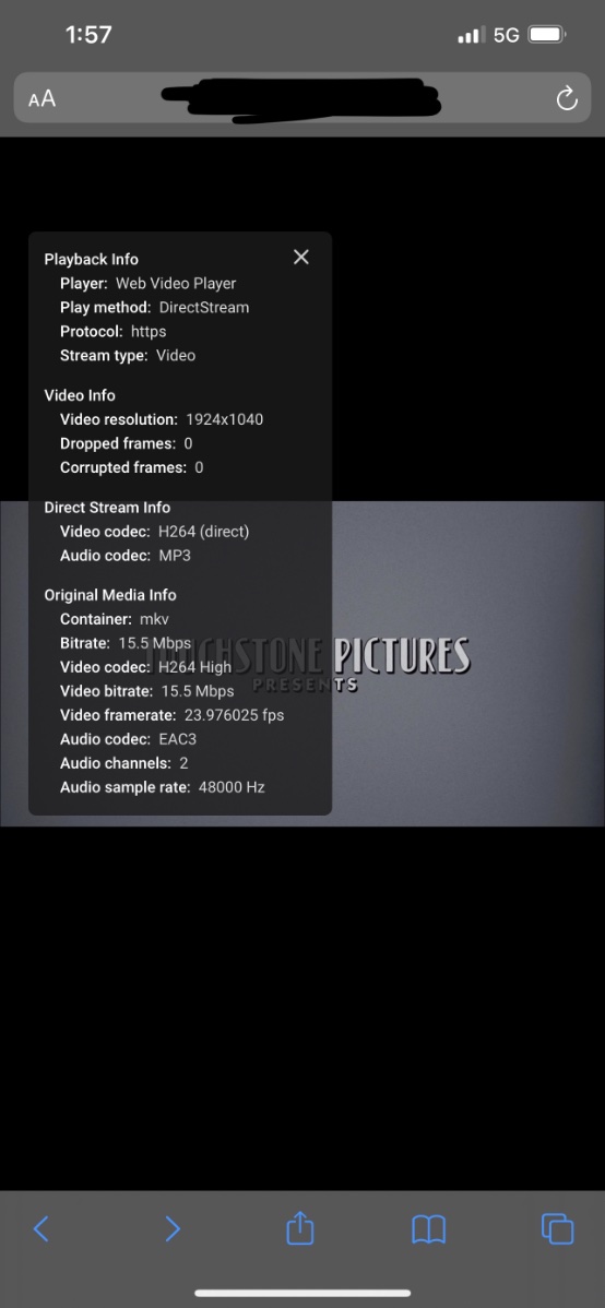

Jcheinaman 19 Posted February 10, 2021 Author Posted February 10, 2021 (edited) I ran a test on the cellular network in the mobile browser with no vpn turned on so that I am able to show you I’m on the mobile network. I don’t know what’s going on here. Regardless it has the same issue outside of the Emby app Edited February 10, 2021 by Jcheinaman

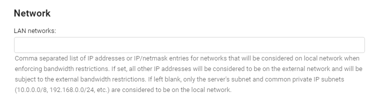

rbjtech 5337 Posted February 10, 2021 Posted February 10, 2021 If Emby is wrong (not sure here) - you can overwrite what it thinks is 'local' on the network config page below. 10.0.0.0/8 172.16.0.0/12 192.168.0.0/16 The above are RFC1918 addresses - so if you add these to the page below - it SHOULD make anything outside these addresses as 'remote'. 1

rbjtech 5337 Posted February 10, 2021 Posted February 10, 2021 So the same thing is happening - emby is classing your WAN IP as 'local' ... Did you see my post above on forcing what emby considers 'local' - this is certainly worth trying imo.
Luke 42204 Posted February 10, 2021 Posted February 10, 2021 I would explore the Emby Server network settings that can help you configure what addresses are considered in network and out of network. 1
Jcheinaman 19 Posted February 10, 2021 Author Posted February 10, 2021 4 minutes ago, rbjtech said: So the same thing is happening - emby is classing your WAN IP as 'local' ... Did you see my post above on forcing what emby considers 'local' - this is certainly worth trying imo. THANKS! I missed that post and I really didn't even think about netmasks. This definitely fixed the issue. Although I'm still concerned why Emby isn't picking up that it was a remote network. I changed this to the solution! Thanks again to everyone for your help!!

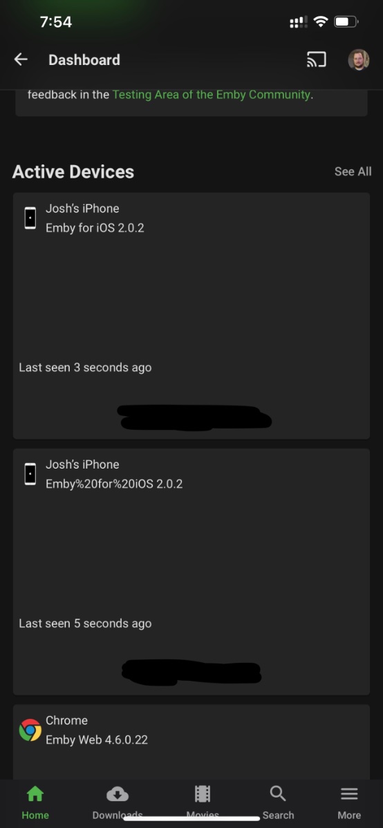

Jcheinaman 19 Posted February 13, 2021 Author Posted February 13, 2021 (edited) As promised in my post directly above, I ran this a few times and I was able to replicate the issue. I included a few pictures from the app. I also included the log. I used my iPhone for these tests, but the app does the same thing when connected with my iPad. Being that this appears to be linked to the app, I'm not sure if the server logs will necessarily help here or not. Call me crazy, but something is definitely out of sorts here. Please let me know if you find anything. Thanks! Direct play from my local network. Proper playback as expected: transcoding, but @ max bitrate on cellular data. I have my network stream limit set to 5mbps. This is when the server dashboard simply states "Transcoding" and has no transcode reason or stats displayed below it. If I was previously connected to the app via a local wifi connection and I don't first manually log out and back into the server, this is the result below. It's almost like the server gets confused? It transcodes, but doesn't limit the bitrate over the remote connection. Stats for nerds doesn't even show the transcode progress. It's almost like it's just saying that the file is transcoding for some reason, but not actually transcoding and simply playing directly: Transcoding on cellular data properly after I log out and back into the server via the iOS app: embyserver.txt Edited February 13, 2021 by Jcheinaman
