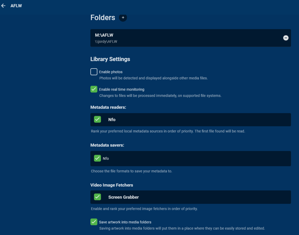

timekiller 5 Posted February 9, 2021 Posted February 9, 2021 Hello! I have an issue where my Emby server is not automatically generating nfo files for new content. All my libraries are setup the same (screenshot attached). I want nfo files stored with the media. Right now thumbnails and .bif files are created, but not nfo. I've tried turning the settings off and back on, but that didn't seem to work. If I manually "Refresh Metadata" on a library the nfo files are created. In the logs I see several lines like this: 2021-02-09 05:06:03.001 Error LibraryMonitor: Error in Directory watcher for: /mnt/Websites *** Error Report *** Version: 4.5.4.0 Command line: /system/EmbyServer.dll -programdata /config -ffdetect /bin/ffdetect -ffmpeg /bin/ffmpeg -ffprobe /bin/ffprobe -restartexitcode 3 Operating system: Linux version 4.19.107-Unraid (root@38721b48cdfb) (gcc version 9.2.0 (GCC)) #1 SMP Sun Mar 8 14:34:03 CDT 2020 Framework: .NET Core 3.1.8 OS/Process: x64/x64 Runtime: system/System.Private.CoreLib.dll Processor count: 8 Data path: /config Application path: /system System.IO.InternalBufferOverflowException: System.IO.InternalBufferOverflowException: Too many changes at once in directory:/mnt/Websites. Source: TargetSite: No Stack Trace Available Full log attached. embyserver.zip

jordy 284 Posted March 8, 2021 Posted March 8, 2021 Hi Folks, When I upload a new video to a library set up as "Home Videos & Photos", The file is auto detected correctly, an image is extracted and correctly named BUT no .nfo file is created. Running the "Scan Library Files" task does not create .nfo files for this library type. In order to create a .nfo file, I need to manually run the "Refresh Metadata" task on the library. Is this intended functionality or a bug? thanks @jordy jordy

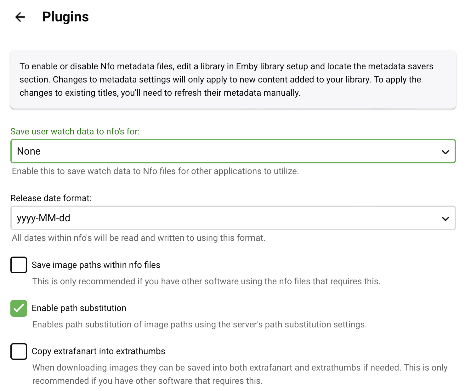

K22R8CT 25 Posted June 8, 2022 Posted June 8, 2022 8 hours ago, Luke said: We don't use watch data with nfos, so I guess it would just be date added. It's in the settings of the Metadata plugin though. And I checked a recent file and confirmed the xml: <watched>false</watched> <resume> <position>0</position> <total>4916.778</total> </resume>
Happy2Play 9814 Posted June 8, 2022 Posted June 8, 2022 17 minutes ago, Anon28109 said: It's in the settings of the Metadata plugin though. And I checked a recent file and confirmed the xml: <watched>false</watched> <resume> <position>0</position> <total>4916.778</total> </resume> Yes, you can assign this info for one user but with Emby being a multi-user platform it no longer reads the information from the nfo. I believe only Kodi will actually utilize this information. Emby tracks all userdata by provider id and if item does not have provider id then a Emby generated id is used, but unfortunately if that media is moved then the status is lost as it will get a new id.
