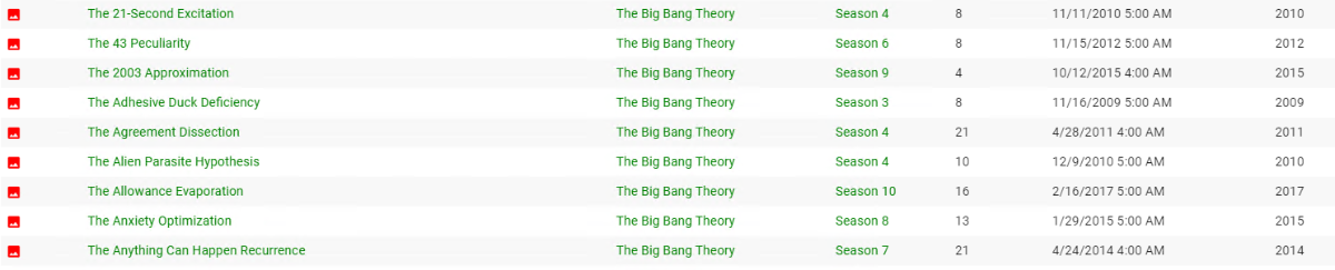

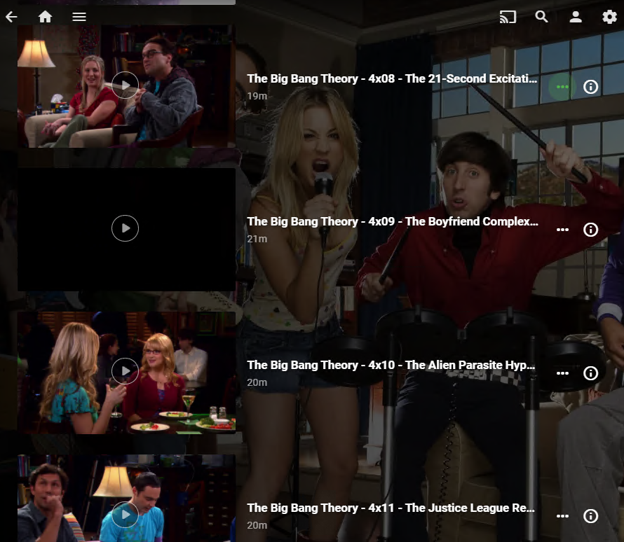

dcook 303 Posted February 7, 2021 Author Posted February 7, 2021 Looks like I spoke to soon, I don't think the Missing Episode filter in the Reports Plugin actually works For example: It thinks all these Big Bang Theory episodes are missing, but they are showing in Emby just fine: Season 4 Episode 8 and 10 are in Emby, but the the Report says they are missing?

dcook 303 Posted February 7, 2021 Author Posted February 7, 2021 Its not specific to Big Bang Theory Its saying I have: 2871 missing episodes Everyone I have checked so far has been false, the episodes are there and showing in Emby with correct name I guess I will look at Sonarr as a solution then, as this Report Plugin clearly has bugs
ebr 16310 Posted February 8, 2021 Posted February 8, 2021 19 hours ago, dcook said: and showing in Emby with correct name None of the episodes in your screen shot above are showing with correct metadata... So, they aren't identified as those episodes and, thus, Emby thinks they are missing.

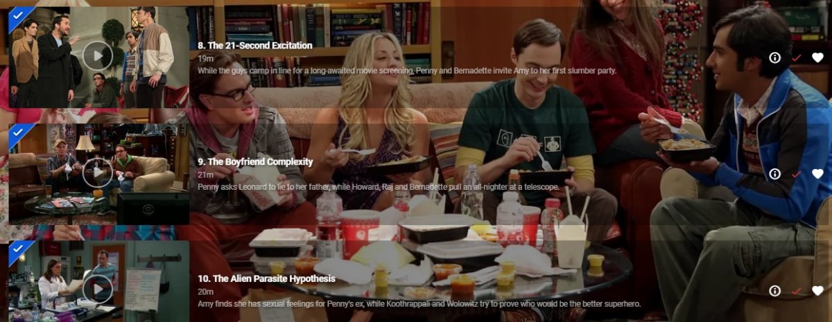

Happy2Play 9802 Posted February 8, 2021 Posted February 8, 2021 (edited) @dcookYep as it should look like this. Your image would appear to show a metadata issue. Also what do you get when you click on missing episodes via the Report as there was/is a bug that causes virtual and actual episodes to be merged so you have to split the virtual and real episode apart. But you can only see the merged items from the missing episode side not the real episode. Edited February 8, 2021 by Happy2Play
