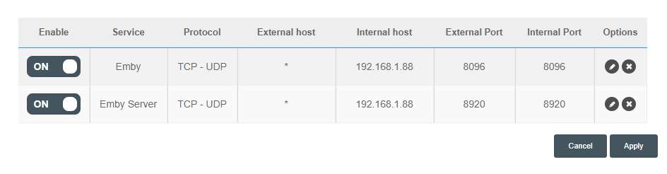

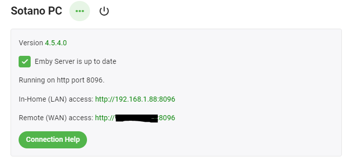

advarito 0 Posted February 5, 2021 Posted February 5, 2021 (edited) Good night fellas. I´m not the greates informatic expert, so please be patient with me. I have followed all the steps provided by the Emby connection guide. The server works amazing on local network, but I am completely unable to make work the External connections. I am using both my phone whithout wifi (on 4G+) and the http://www.canyouseeme.org/ webpage. When trying to connect, I get an error, page was not found. On http://www.canyouseeme.org/, the message says: Error: I could not see your service on xx.xx.xx.xxx on port (8096) Reason: Connection timed out I already forwarded the ports on my router and added the inbound connections to the windows firewall. Maybe I am missing a basic step or my router is a bit weird, the model is Sagemcom fast 5657, seems like is a special model made for the internet company here in Spain, so very little information is online about it. This is the main Router with optic fiber, and the computer with the server is connected by cable. Any help that you can tell me will be very much appreciate it, so I look forward to read any new instructions. If you need more information or pictures, no problem no provide them. Thank you before hand. Edited February 5, 2021 by advarito

Carlo 4561 Posted February 6, 2021 Posted February 6, 2021 Hi, your port forwarding looks good ok but only TCP needs forwarding. Does the IP shown in the dashboard for the remote IP (your wan IP) the same as what canyouseeme.org shows? If you run a tracert to 8.8.8.8 does it show any 10.x or 192.x IP as the 2nd or 3rd listing?
advarito 0 Posted February 6, 2021 Author Posted February 6, 2021 44 minutes ago, cayars said: Hi, your port forwarding looks good ok but only TCP needs forwarding. Does the IP shown in the dashboard for the remote IP (your wan IP) the same as what canyouseeme.org shows? If you run a tracert to 8.8.8.8 does it show any 10.x or 192.x IP as the 2nd or 3rd listing? Changed to only TCP Forwarding. Yes, the IP is the same. In fact, canyouseeme.org automatically recognizes the public IP and does not allow me to change it. Yes it does show those ip on 2nd and 3rd I have to add that my DNS, both router and PC are change to 1.1.1.1 and 1.0.0.1 of cloudflare. Should I change it to google´s? Thank you
Carlo 4561 Posted February 6, 2021 Posted February 6, 2021 Hops 3 & 4 using the 10.x range show that your ISP is using private IPs which are NOT routable to the outside Internet. These address ranges are used for CGNAT (Carrier Grade Network Address Translation). This is basically the same thing your router does with NAT only on a much larger scale. What you will need to do is contact your ISP and ask for a Static IP with a real Internet IP address that is routable. Almost all ISPs will give you this when asked but might charge a couple bucks for it. Once you have a routable IP address (reboot router) your current setup should work!

Solution pwhodges 2028 Posted February 6, 2021 Solution Posted February 6, 2021 1 hour ago, advarito said: I understand, could this problem be fixed by a DynDNS? No, because the problem is not that your external address changes, but that there is no port forwarding through the cgNAT inside your ISP. You can set up port forwarding through your own NAT, in the router, but this is not going to happen in the ISP's network unless you can negotiate a fixed address (and the port forwarding) with them. Paul 1
