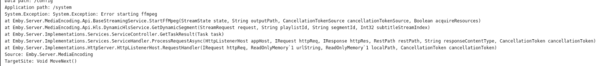

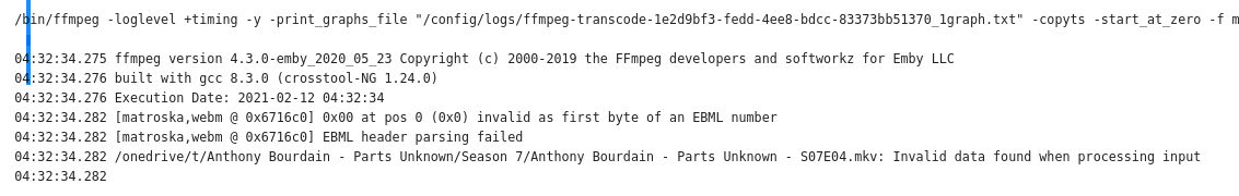

herki 3 Posted February 12, 2021 Author Posted February 12, 2021 Hi there, back again with same issue. I've screenshot what should be relevant parts of embylog and transcode log. Have some info in complete log that I think would want private but let me know if you need more ty. Here is transcode log: Here is emby log: also tried streaming externally to VLC which plays everything native on 4k fire stick - no dice. Ty
herki 3 Posted February 12, 2021 Author Posted February 12, 2021 Also if it helps. My brothers box which is exact same setup as mine, pulls from same library and the file works there with identical setup.
