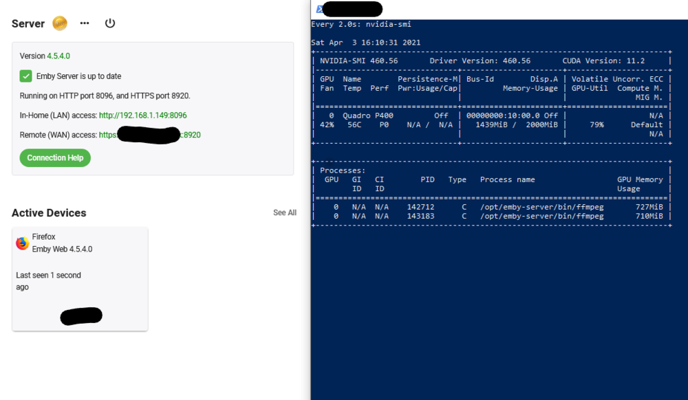

Tau512 15 Posted April 3, 2021 Posted April 3, 2021 bit of a +1 to this. i'm seeing same the zombie process with symptoms as OP. I discovered it via nvidia-smi tool (Linux server also) when becoming curious how much memory usage per stream-type. the quadro p400 only has 3 NVENC streams available so aside from the stray processes causing undesirable load, this appears it could actually block future playback of any media type assuming it's transcoding. source content is 4k I'm waiting excitedly for the 4.6.x beta to turn final as i've see the changelogs and expectations of the 4.6 release which should bring a lot of useful fixes&features for me hopefully a fix for these zombie processes can be included!
