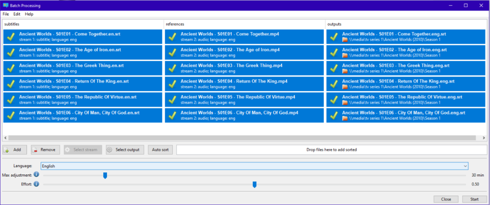

Ronstang 294 Posted February 3, 2021 Posted February 3, 2021 I have been having trouble lately with subs from certain channels I record movies from being out of sync and it is frustrating. I encode and store all my movies so I extract the CCs from the video and convert to SRT automatically. I found a great tool called SubSync that actually listens to the audio and then will automatically sync the subtitles by saving a new SRT file. It takes a few minutes but so far it has been extremely accurate for me. You can use the subtitle offset function in Emby but instead of fiddling with that and then having to deal with helping others watching my files in the house I prefer to use SubSync to make a permanent solution that is portable and will work on any player you use anywhere because you have corrected the core sub file. 1
rbjtech 5345 Posted February 3, 2021 Posted February 3, 2021 (edited) Useful info thanks .. just seen subsync has a CLI, I wonder if I could incorporate an SRT sync 'check' as part of my post media processing .. Edited February 3, 2021 by rbjtech
Ronstang 294 Posted February 3, 2021 Posted February 3, 2021 54 minutes ago, rbjtech said: Useful info thanks .. just seen subsync has a CLI, I wonder if I could incorporate an SRT sync 'check' as part of my post media processing .. I wish there was a way to make SubSync an automatic tool that I could batch run on a directory of directories because it's smart enough to know when and if subs are in sync and it even has the ability to translate the language spoken to sync other language subs to the audio. It's a slick and accurate tool but it is completely manual at the time, not a huge deal because MGM Movie Channel is the one I always have trouble with so as soon as I encode a movie I run it through SubSync before I put it into my library.
rbjtech 5345 Posted February 3, 2021 Posted February 3, 2021 (edited) It looks to be an extremely capable utility - and I see no reason at all why you could not scan your entire collection with an iterative script that 'corrects' the subtitle sync as it goes... CLI Options .. A great find - thanks - I'm going to have a good look at this when I get a bit of time. Having a 're-sync' button in Emby would also be perfect - as my sync on a test file only took a few seconds.. impressive. edit - even better - it has a batch mode ! Just run 'subsync --batch' from the command line and it will allow you to drag and drop files/folders .. Edited February 3, 2021 by rbjtech
