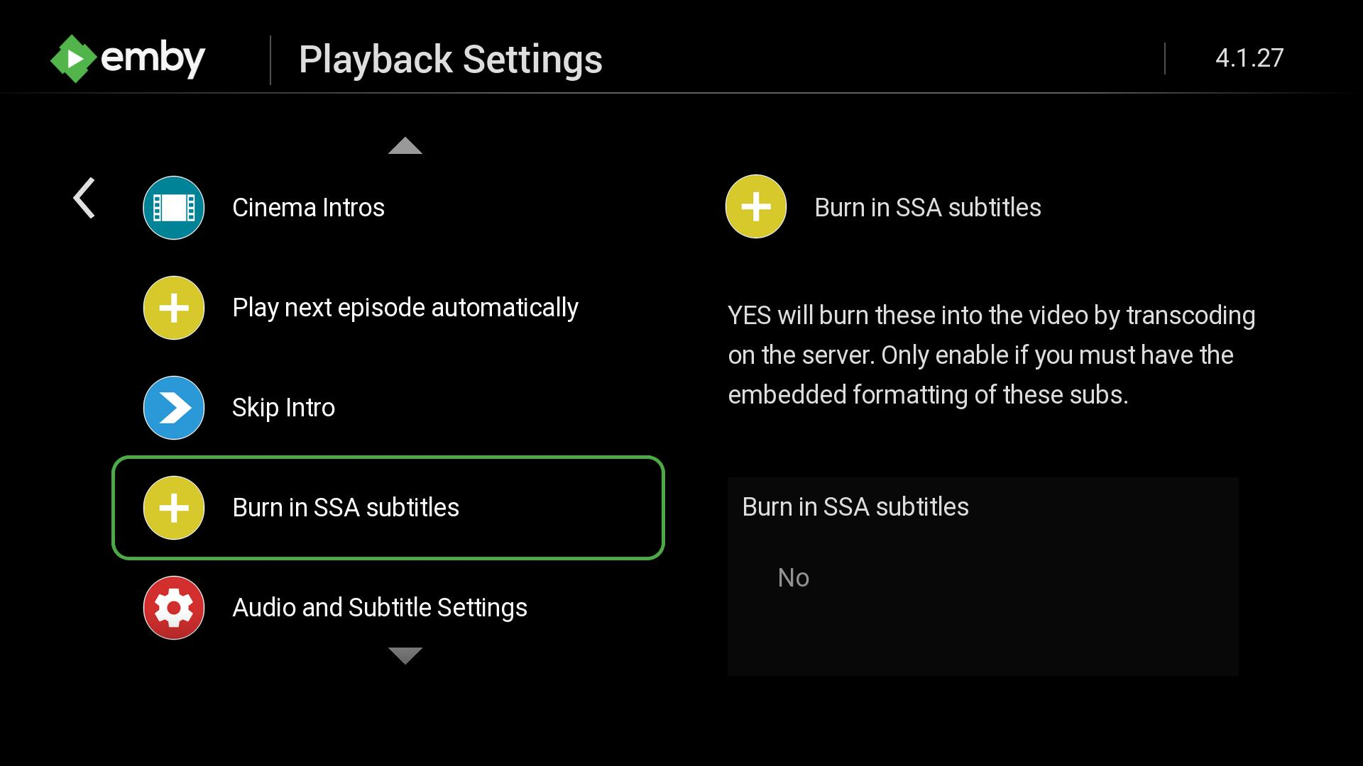

Solution ebr 16332 Posted February 1, 2021 Solution Posted February 1, 2021 Hi. There is an option in the app settings to burn these in for proper formatting. Set that to "Yes".
Monkrocker 2 Posted February 1, 2021 Author Posted February 1, 2021 39 minutes ago, ebr said: Hi. There is an option in the app settings to burn these in for proper formatting. Set that to "Yes". Boom. You are both a gentleman and a scholar, sir.
plittlefield 56 Posted October 1, 2024 Posted October 1, 2024 Where is this setting in the Emby app and what do I need to set on my Roku for as well?
Luke 42239 Posted October 1, 2024 Posted October 1, 2024 1 hour ago, plittlefield said: Where is this setting in the Emby app and what do I need to set on my Roku for as well? Hi, it should be in the app playback settings.

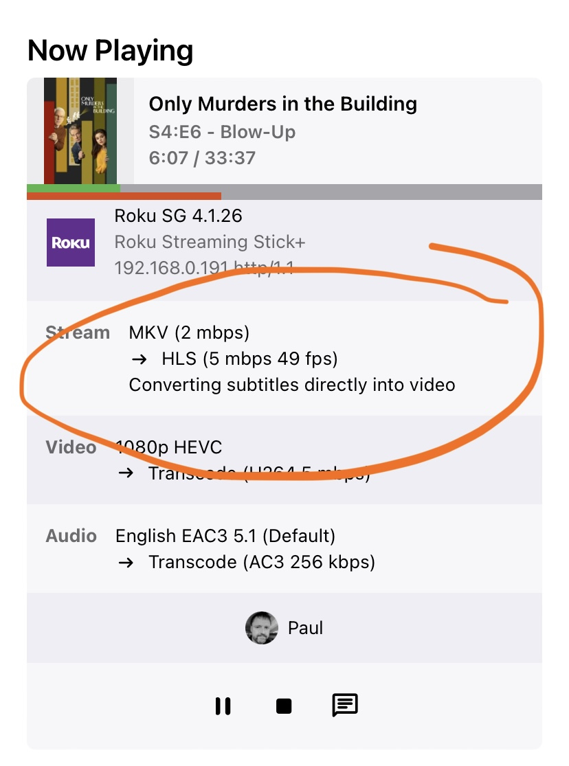

plittlefield 56 Posted October 1, 2024 Posted October 1, 2024 (edited) Oh, here is the info from the Admin … … it shows burning in but nothing is on the screen. Over to you guys! Edited October 1, 2024 by plittlefield
ebr 16332 Posted October 1, 2024 Posted October 1, 2024 Hi. Please provide the ffmpeg log from that session.
plittlefield 56 Posted October 2, 2024 Posted October 2, 2024 Here you go ffmpeg-transcode-61b77653-1e58-4f56-b7e0-84b5d5e9c0cb_1.txt
