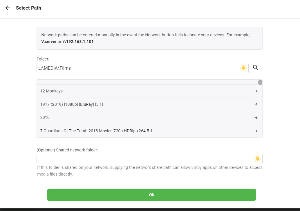

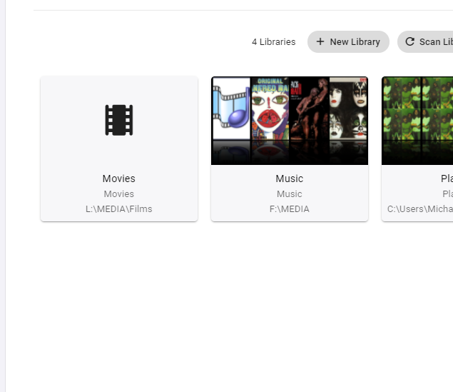

Michael1952 1 Posted January 31, 2021 Author Posted January 31, 2021 Luke, Here is the screens i see Hew3re is the path to my files after selecting the path it appears to scan moving rapidly from 0 to about 80% then on to a 100% more slowly. After reaching 100% there are no files recorded and none displayed. hope that makes things more clear. Thanks
Michael1952 1 Posted February 1, 2021 Author Posted February 1, 2021 The forth library is Recorded TV.

Happy2Play 9802 Posted February 1, 2021 Posted February 1, 2021 @Michael1952 Nothing stands out in the log but there is no reference to "L:\MEDIA\Films" though. Only other thing I can think of is maybe going to Emby-Logs and enabling Debug logging, restarting Emby and performing a scan again and posting another log. Unless @Luke has any other ideas.

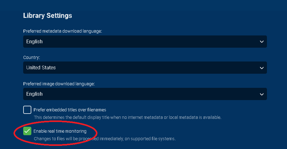

Carlo 4561 Posted February 1, 2021 Posted February 1, 2021 Hi, can you try a couple things for me? Go to this library settings turn on advanced and turn on real time monitoring. Then go to plugins and remove port mapper. Restart server and perform a library update. Post new server log when it completes the library scan.

Michael1952 1 Posted February 1, 2021 Author Posted February 1, 2021 Ok guys here's what i have done . Cayars I went to the the library settings and Checked is "real-time monitoring" was checked and it was checked already, I am sorry Romstang, I don't know how and could find no info in the knowledge base on scanning from the dashboard, I did as you suggested and removed the library and scaned then added the library again and scanned but had the same outcome. Here is the log file for the scan that i did: embyserver.txt

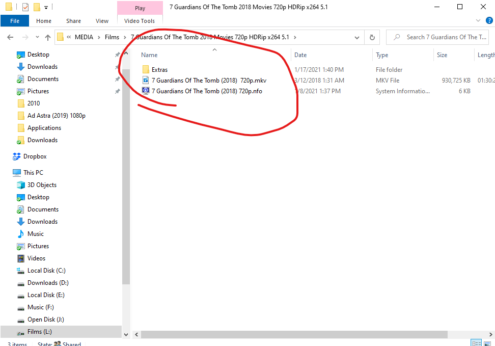

Luke 42204 Posted February 1, 2021 Posted February 1, 2021 How are the files named and organized underneath there?
Michael1952 1 Posted February 1, 2021 Author Posted February 1, 2021 Luke I have used the recommended folder format for my files Here's an example of the folder structure:l And here is an example of the sub-folder: Fairly standard i guess.
Michael1952 1 Posted February 1, 2021 Author Posted February 1, 2021 nope but it is an external/portable hard drive. (USB)
