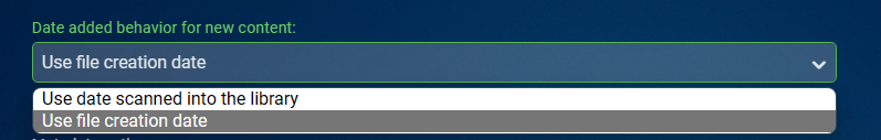

Carlo 4561 Posted January 3, 2023 Posted January 3, 2023 Have you checked out the advanced tab in library setup? This can come in handy if you ever reload a library. Set it to use the creation date to get everything scanned in then, switch it to scanned into the library. That keeps you from having everything with a similar date. Set to "Use date Scanned into the library" should do what you're describing.
solidsnakex37 55 Posted January 4, 2023 Posted January 4, 2023 1 hour ago, cayars said: Have you checked out the advanced tab in library setup? This can come in handy if you ever reload a library. Set it to use the creation date to get everything scanned in then, switch it to scanned into the library. That keeps you from having everything with a similar date. Set to "Use date Scanned into the library" should do what you're describing. Those settings are actually what brought me to this post, though I don't think I did it in the way you described it. I am new to Emby, so I originally set that to "Use file creation date" when first setting up my library. But I noticed when something was upgraded it would mess up the recently added where I only want actual new stuff to show. So if I am understanding correctly, set it to use creation date, then save it. At that point do I trigger a full library scan? Then when it's completed, set it to "Use date scanned into the library"? Similar to the OP, I changed how Radarr manages my media where before it was {Title} {Year} {Quality Full} so for example Mortal Kombat (1995) - 1080p I may have messed up my entire movie library in Emby by trying this, but if I understand your comments correctly above, my new naming scheme is now {Movie Title} ({Release Year}) {TmdbId} for the file name. So if something is upgraded, and the issue is that Emby sees the file name change, this theoretically should stop that since the quality is removed and the file name will be the same regardless of it's quality.

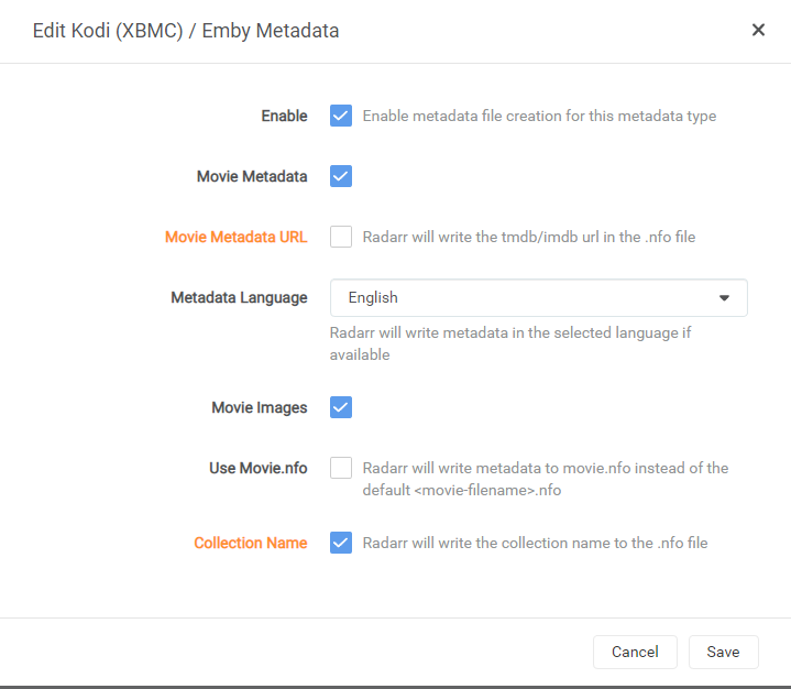

Happy2Play 9800 Posted January 4, 2023 Posted January 4, 2023 (edited) There is actually missing info here. As an item with a written nfo file cannot lose date added when file is changed/updated/replaced. From a database only standpoint sure as it becomes a new item. So, any programs that mess with the nfo file or deletes it will drive Emby to undesired results. I know myself as a xml user will always have a set DateAdded value as Emby only reads the file. But in the end I would be talking to Radarr not Emby as they create the issue if it were me. Edited January 4, 2023 by Happy2Play 1
solidsnakex37 55 Posted January 4, 2023 Posted January 4, 2023 (edited) 41 minutes ago, Happy2Play said: There is actually missing info here. As an item with a written nfo file cannot lose date added when file is changed/updated/replaced. From a database only standpoint sure as it becomes a new item. So, any programs that mess with the nfo file or deletes it will drive Emby to undesired results. I know myself as a xml user will always have a set DateAdded value as Emby only reads the file. But in the end I would be talking to Radarr not Emby as they create the issue if it were me. I didn't have this issue on Jellyfin which is where I migrated everything over from, so I thought some of that functionality would be the same. Though I don't know how that is handled in JF. I did find this option in Radarr, maybe this will help Emby know how to better process the files. Though, unsure the best configuration to just do what I need it to. Edited January 4, 2023 by solidsnakex37 Information I stated was wrong, there is a date added
solidsnakex37 55 Posted January 4, 2023 Posted January 4, 2023 Is there a possible option to have Emby decide the behavior for new content, without looking at the metadata value? I know it in my screenshot below, that when a metadata value is present it will be used before either of the above options. So that kind of negates whatever setting I use...What if I don't want that to happen?
