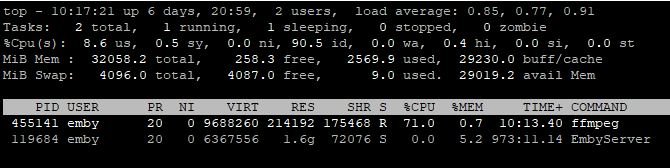

Thor.2 1 Posted February 3, 2021 Author Posted February 3, 2021 Sorry for the delay I rebooted emby when there were no client connected, and no tasks but 29.1GB of RAM used. Now again today there is 13 GB with one client running. I don't see anything in the server log that points towards memory usage, so I am not sure that will be much help. There is definitely some sort of memory leakage Thanks embyserver (2).txt
Q-Droid 1011 Posted February 3, 2021 Posted February 3, 2021 Your shot of top is showing 1.5 GB used, emby is using about 1GB resident. Nearly 30GB is available memory being used as cache because unused memory is wasted memory. Nothing from your screen shot looks out of the ordinary. It just looks like a system with a good amount of file I/O which has been cached.
Thor.2 1 Posted February 3, 2021 Author Posted February 3, 2021 Yes I am aware of that but it gets locked to Emby, and will not be released for other resources. Then swap is used and the server slows to a crawl. There is no need to hold onto that much cache
Q-Droid 1011 Posted February 3, 2021 Posted February 3, 2021 Not sure what you mean by "locked to Emby". The file buff/cache is a system managed resource, borrowed memory when not needed for other functions. What are you using to monitor the memory consumed by the emby processes?

Q-Droid 1011 Posted February 6, 2021 Posted February 6, 2021 Are you using a ramdisk for any of the conversion work? If this new top capture is a snapshot of the system during a conversion there is no indication of high memory usage or swap issue. The swap used is negligible, 9MB out of 4GB. Active mem used (RES) is low and available mem is high. Having some swap usage is normal and not a bad thing. If the application process is writing to files then it does get written to disk. There is no need to "flush" memory if it's not being requested, that is extra work and it gets reclaimed when needed. So what is the actual problem you are trying to resolve? What are the symptoms?
