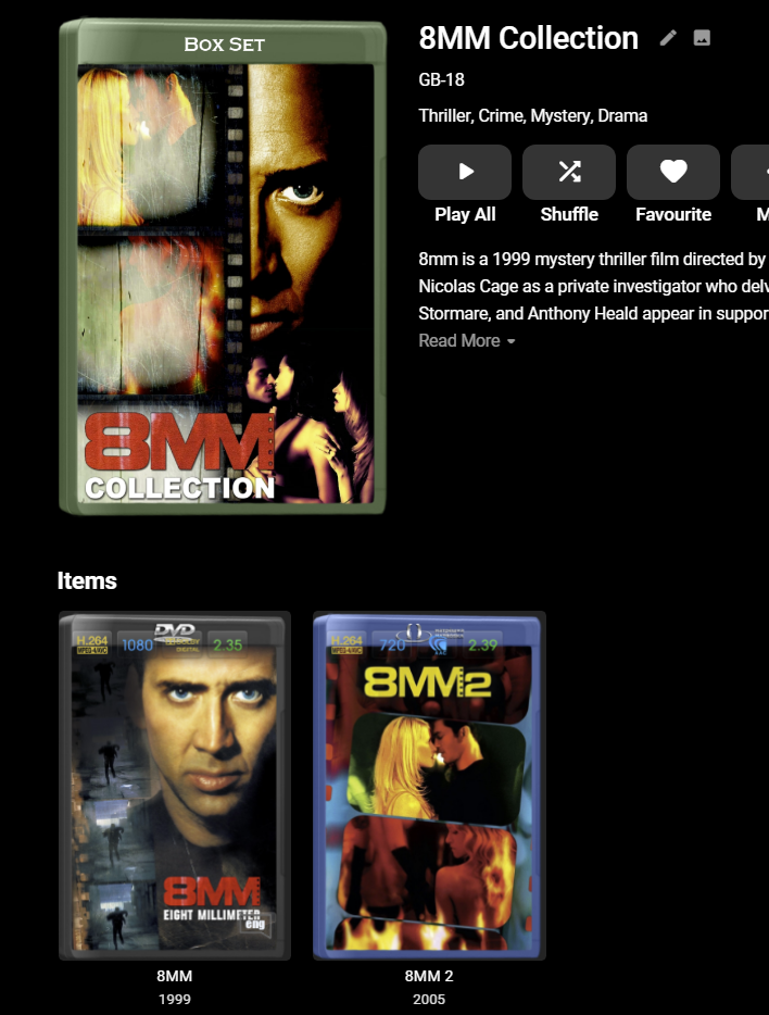

tmb4016 93 Posted April 10, 2021 Posted April 10, 2021 Hi roaku, OK - I was expecting an icon on the actual collection so that explains my error... However on testing the rule I had been playing with I still do not see any processing on the individual movies... I do not see any errors in the log file and it does appear as if the plugin is triggering but no icon displayed... It is not critical for me but it would be interesting to find the issue. I am more interested in having icons appear on Collection posters for things like tags etc. I am nmot sure if this is on you roadmap. Thanks again for the explanation and the great plugin so far.
roaku 842 Posted April 10, 2021 Author Posted April 10, 2021 @tmb4016 Hmm... Iconic is working for your other rules? It's just this one rule that's failing? When you go to the main list of movies and scroll to the 8MM movies, is the icon missing there, too? ------- And yes, rules for Collections and TV will be coming in the future.

tmb4016 93 Posted April 12, 2021 Posted April 12, 2021 (edited) @roaku - Yes iconic is working great on the other rule sets. Mainly tag but one filestream and one filename. It also works on those movies for example if I add an appropriate tag so it is specific to the Collection rule set. Yes even if I browse those movies from the main Movie library rather than the collections view the icon is missing. I've tried a couple of others as well. The 8 mm one just happened to be the first collection. Should have pointed out this is on the beta build 4.6.0.37 and it was a new library build so all collections have been built from scratch using the new methodology rather than migrated. Edited April 12, 2021 by tmb4016 corrected
roaku 842 Posted April 12, 2021 Author Posted April 12, 2021 7 hours ago, tmb4016 said: @roaku - Yes iconic is working great on the other rule sets. Mainly tag but one filestream and one filename. It also works on those movies for example if I add an appropriate tag so it is specific to the Collection rule set. Yes even if I browse those movies from the main Movie library rather than the collections view the icon is missing. I've tried a couple of others as well. The 8 mm one just happened to be the first collection. Should have pointed out this is on the beta build 4.6.0.37 and it was a new library build so all collections have been built from scratch using the new methodology rather than migrated. Ok, ya, the beta is likely the answer here. I'll update the plugin as needed to support the changes the next release brings, but I don't try to support the beta builds.

tmb4016 93 Posted May 26, 2021 Posted May 26, 2021 I still am not seeing the Collections rule working. I've added some movies to a collection called 100 Poster - When I check the movie library the image for movies included in the Collection do not display the iconic image. However from the Movie Library ... There is no enhancement. The configuration is shown below.... All other rules seem to be fine. Running 4.6.0.52 Initial though this was beta related but still there...
roaku 842 Posted May 26, 2021 Author Posted May 26, 2021 2 hours ago, tmb4016 said: I still am not seeing the Collections rule working. I've added some movies to a collection called 100 Poster - When I check the movie library the image for movies included in the Collection do not display the iconic image. However from the Movie Library ... There is no enhancement. The configuration is shown below.... All other rules seem to be fine. Running 4.6.0.52 Initial though this was beta related but still there... I'm taking a look at this now.
ebr 16341 Posted May 26, 2021 Posted May 26, 2021 The two "Three idiots" images look identical to me. What am I missing...?
roaku 842 Posted May 26, 2021 Author Posted May 26, 2021 1 minute ago, ebr said: The two "Three idiots" images look identical to me. What am I missing...? I think they're saying that the Collections rule isn't working in any view, but the 'however' phrasing is misleading. That's the behavior I'm seeing, anyway, for *newly created* collections in 4.6.x. I had only checked that my existing collections and playlists were still having their icons generated after upgrading to 4.6.x. I suspect my query to retrieve a collection/playlist's items needs attention.
tmb4016 93 Posted May 26, 2021 Posted May 26, 2021 (edited) @roaku - yep apologies for the confusion. The movie image should show an iconic treatment because it is in a collection that is covered by the rule. No treatment is happening though hence the image does not include the icon. When I check the logs the iconic plugin is not being triggered for this item only the coverart. @ebr - yes you are correct they are identical and should be but they should include an iconic icon in the bottom left... Cheers Edited May 26, 2021 by tmb4016
roaku 842 Posted May 26, 2021 Author Posted May 26, 2021 6 minutes ago, tmb4016 said: @roaku - yep apologies for the confusion. The movie image should show an iconic treatment because it is in a collection that is covered by the rule. No treatment is happening though hence the image does not include the icon. When I check the logs the iconic plugin is not being triggered for this item only the coverart. @ebr - yes you are correct they are identical and should be but they should include an iconic icon in the bottom left... Cheers No problem. Please install Iconic version 1.1.1 from your Plugin - Catalog view, restart, and let me know if that solves the Collection rule problem for you. 1
tmb4016 93 Posted May 26, 2021 Posted May 26, 2021 Hi roaku - Upgraded to 1.1.1 and I can confirm the Collection Rules now show correctly for Collections created in the latest version. Thanks for the speedy response and the great plugin again. 1
