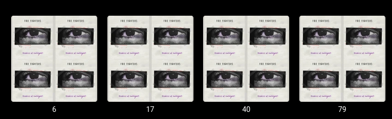

negativzeroe 80 Posted January 25, 2021 Posted January 25, 2021 (edited) Restarted the server to get fresh logs, I have Lidarr tagging and auto-arranging my music which creates the numbered genres. I have the Genre Cleaner plugin set to remove those and to map some fringe genres to others. This does not happen if I run the regular library scan, but if I go to Genre cleaner, then edit, then save, then run the scan from there, it does. To my knowledge it's only running the regular library scan, but it's not hooking in during the scheduled task. Log reflects the actions I just mention. embyserver.txt Edited January 25, 2021 by negativzeroe
