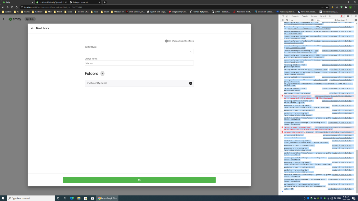

Apostolos M. 1 Posted January 23, 2021 Author Posted January 23, 2021 (edited) Let's start from the beginning. Yesterday I did a fresh installation of Windows (10 x64 build 19042.746) in order to solve this issue. After installation was completed and all drivers were installed, I installed Chrome latest version (88.0.4324.104 (Official Build) (64-bit)). After that I installed Emby server and after I chose language and I gave my username and password I tried to build a new library. On the new library screen I chose my movies folder but I cannot choose the content type. The drop down box does not drop. Also when I press the ok button nothing happens. I am sending a screenshot. I tried Edge as well but the same thing happens. I am sending also from Chrome Developer tools, the Console log. localhost-1611380842875.log Edited January 23, 2021 by Apostolos M.
Carlo 4561 Posted January 23, 2021 Posted January 23, 2021 Hi, Do you have any browser addons that migrated with your username? If so turn them off, restart your browser and try again. Did you install any security software at all besides the built in windows defender?
Apostolos M. 1 Posted January 23, 2021 Author Posted January 23, 2021 No antivirus, no plugins. That's why I did the installation of Emby after I installed Windows, in order to avoid any interferences. I even uninstalled Chrome and used Emby on Edge. Same thing.
GrimReaper 4861 Posted January 23, 2021 Posted January 23, 2021 Just now, Apostolos M. said: No antivirus, no plugins. That's why I did the installation of Emby after I installed Windows, in order to avoid any interferences. I even uninstalled Chrome and used Emby on Edge. Same thing. If you used latest Egde, it's Chromium based so it would basically be same thing. Try using different-engine browser, for example Firefox (Gecko), so you could possibly narrow it down.
Apostolos M. 1 Posted January 23, 2021 Author Posted January 23, 2021 It works fine with Firefox. I think I will switch from Chrome to Firefox. I do not understand though the reason for this incompatibility. And the fact that nobody else reports it at the forum. Thanks you very much.

Solution Apostolos M. 1 Posted January 24, 2021 Author Solution Posted January 24, 2021 I found the solution. A piece of hardware was causing the problem. I removed it and now I hope my problems will be solved.
Carlo 4561 Posted January 24, 2021 Posted January 24, 2021 What was the hardware? Game controller of some kind?
Apostolos M. 1 Posted January 24, 2021 Author Posted January 24, 2021 (edited) https://www.chproducts.com/Pro-Pedals-v13-d-716.html Edited January 24, 2021 by Apostolos M.
Carlo 4561 Posted January 24, 2021 Posted January 24, 2021 Microsoft in their infinite wisdom changed the way game controller can access apps and browsers which is good for games but can throw a monkey wrench into other programs as they throw out events that look like mouse and keyboard activity.
