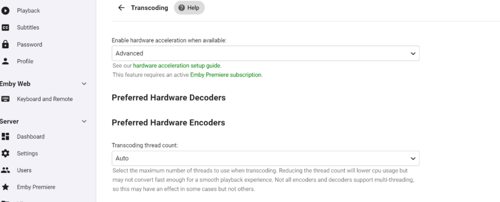

RusticWalls 0 Posted January 17, 2021 Posted January 17, 2021 Hey, Not exactly sure what I am doing incorrectly. Looking for some guidance. Currently running Proxmox 6.2-6 Ryzen 3800x gigabyte b450m ds3h RTX 2070 32GB DDR4 I have an Ubuntu 20.04.1 VM setup. I used DockSTARTer to install my dockers, I have also added - NVIDIA_VISIBLE_DEVICES=all - NVIDIA_DRIVER_CAPABILITIES=all to my Compose file. I can see that those variables show up inside of Portainer when checking the docker. Nvidia drivers 460 installed. I have already passed the GPU through to my Ubuntu 20.04.1 LTS VM, checked by NVTOP Ive gone through the Docker HWA Nvidia Instructions three times but none has succeeded. Nouveau seems to be disabled and Ive attached what i see in my Transcode settings screen along with an "hardware_detection" log. hardware_detection-63746438242.txt

RusticWalls 0 Posted January 18, 2021 Author Posted January 18, 2021 Just now, Luke said: Perhaps DockStarter is adding some unforeseen variables to this? I don't think we've ever tested using that before. To be honest I had never heard of it. Hey, I did step 1-2, When i checked /etc/docker/daemon.json from step 3 the code was already there. (assuming Nvidia installer did that). Restarted for step 4. Created the Emby docker and checked ENVs enabled in the guide to what i had manually enabled, and cross checked in Portainer. After that i checked Emby but Hardware acceleration would not populate. I checked the hardware detection logs and see that libcuda has errors. tried running sudo apt install nvidia-cuda-toolkit but i get Errors were encountered while processing: nvidia-dkms-460 nvidia-driver-460 E: Sub-process /usr/bin/dpkg returned an error code (1) Not sure what to do.
