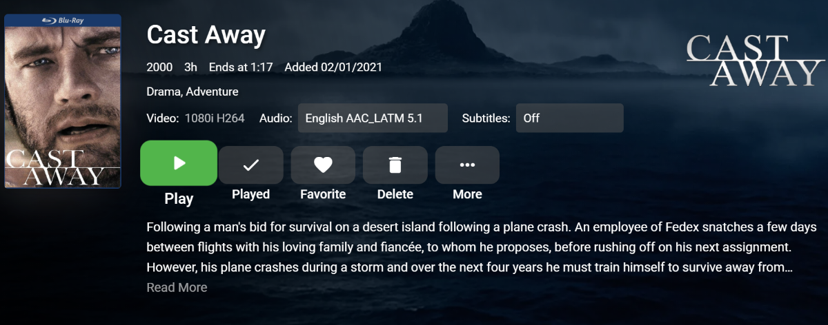

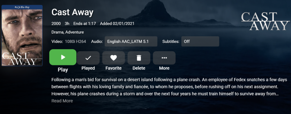

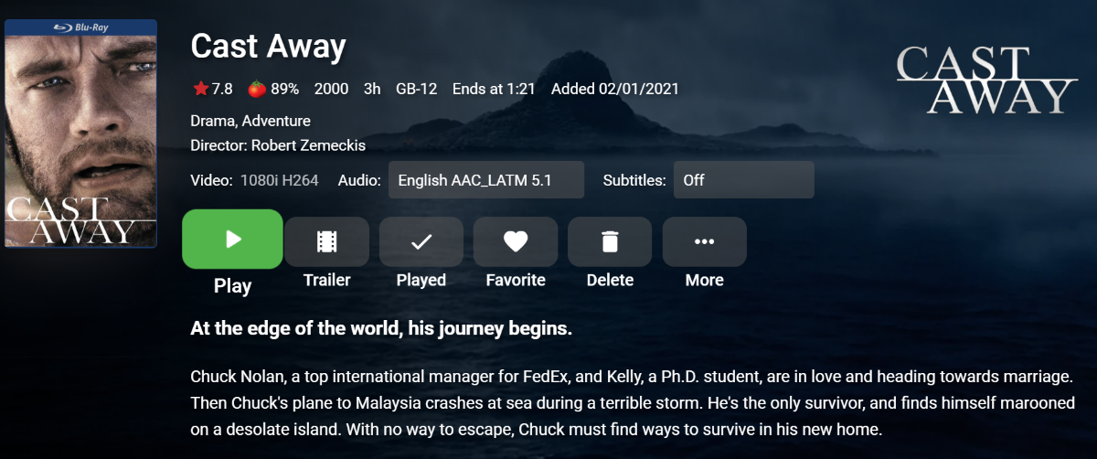

warrencalvert 16 Posted January 17, 2021 Author Posted January 17, 2021 Hi Yes, I think you're right, its probably getting basic metadata from the guide but to get full metadata I have to manually download it. Please see screenshots below. The first is for a movie that was recorded from TV recently. It has only partial metadata. The 2nd screenshot is after I click More/ Refresh Metadata How can I get it to automatically download full metadata? thanks, warren.

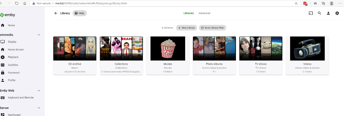

Carlo 4561 Posted January 18, 2021 Posted January 18, 2021 From Web Dashboard if you click on Library menu do you see a RECORDING library with your other libraries listed?
warrencalvert 16 Posted January 18, 2021 Author Posted January 18, 2021 No, I dont see that library. I just see the libraries below.

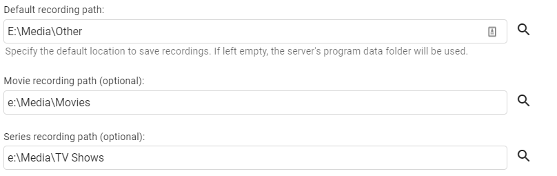

Carlo 4561 Posted January 18, 2021 Posted January 18, 2021 This is likely contributing to your issue. What paths do you have set for these 3 fields?
warrencalvert 16 Posted January 18, 2021 Author Posted January 18, 2021 Only the Movie and TV Shows paths are used. The Other folder doesnt even exist. Movies all go to the Movies folder and TV Shows all go to the TV Shows folder and this works perfectly. Now you mention it, I do remember maybe a year ago I had a lot of issues with multiple duplicate libraries appearing on the home screen. I think this might have been the Recordings library. If this should be present in the Libraries list, should I just add it manually? If so, what folder path should I point it to? I also seem to remember the paths cant be duplicated or even subdirectories duplicated across multiple libraries. So I'm really not sure how the Recordings library should look or what folder it should point to.
Carlo 4561 Posted January 18, 2021 Posted January 18, 2021 Create the folder "E:\Media\Other" so that you have a valid RECORDING LIBRARY default folder.
