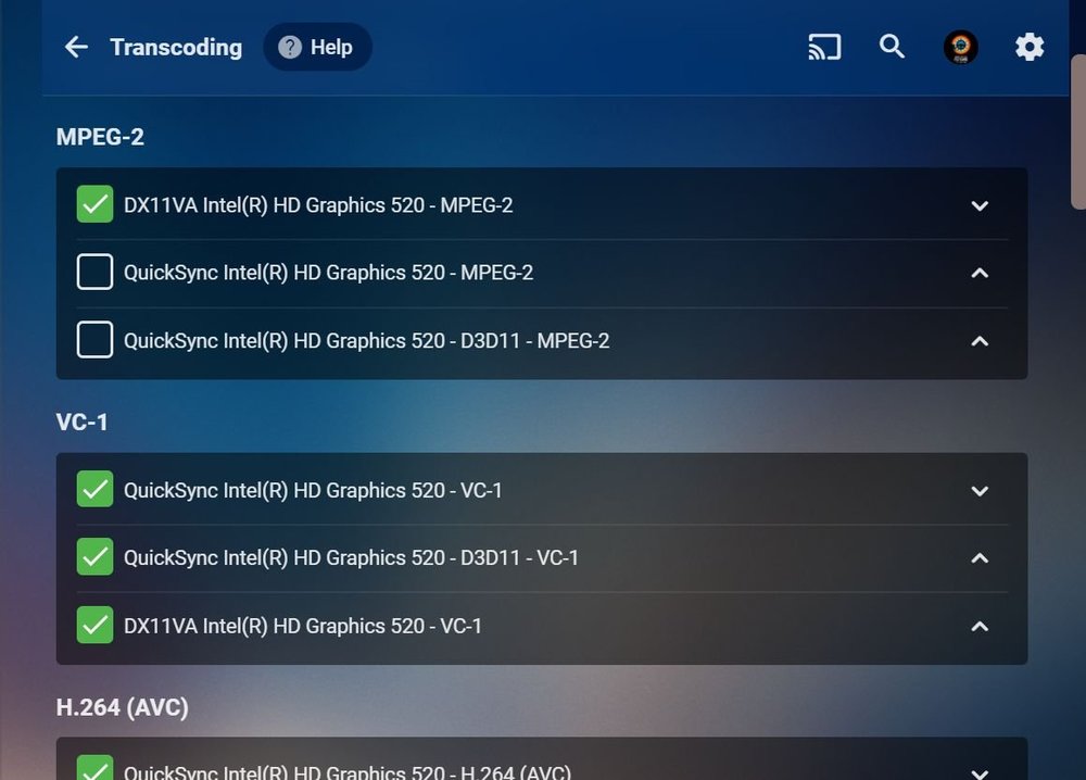

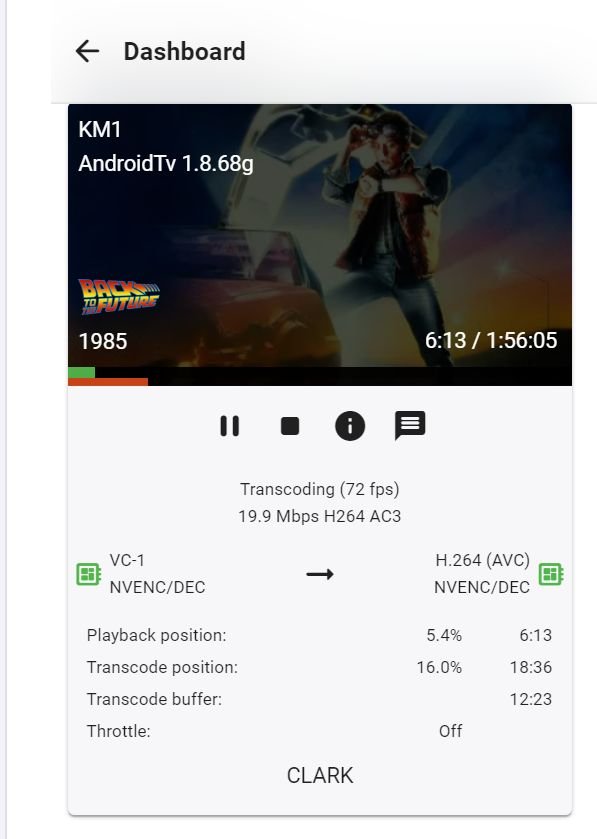

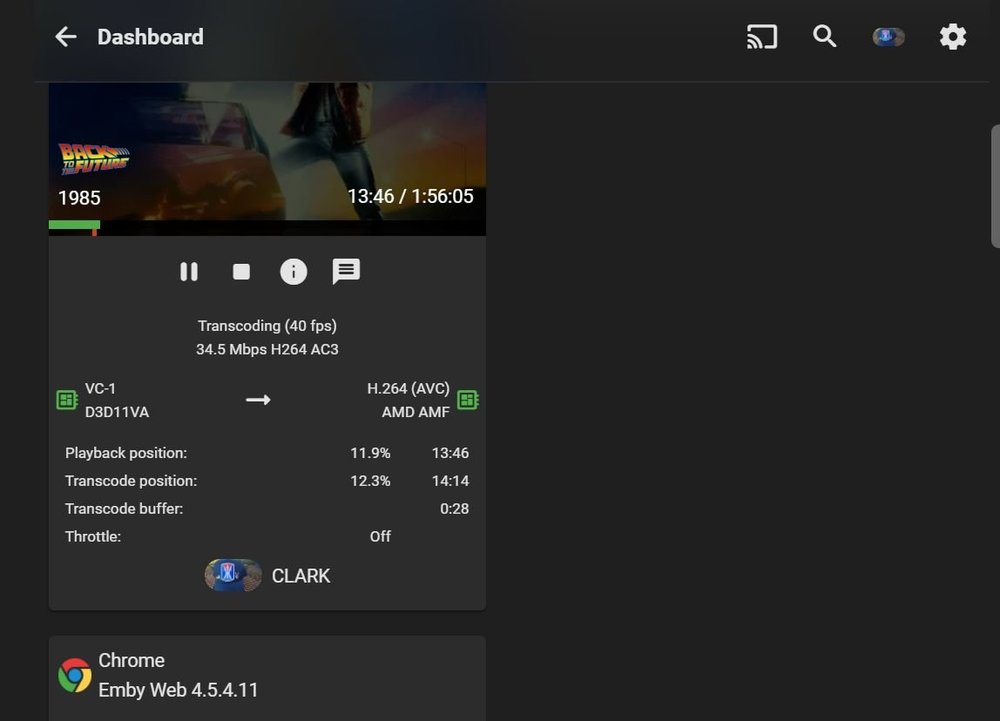

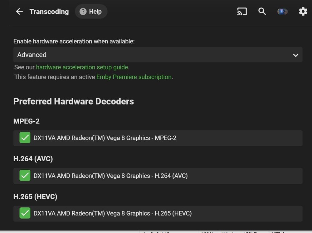

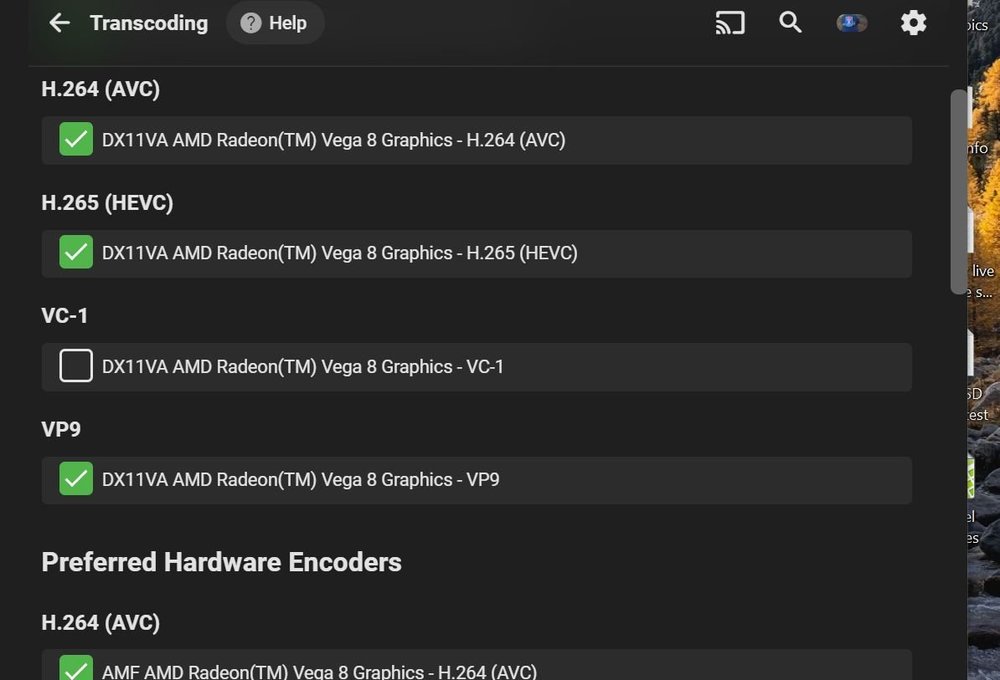

clarkss12 304 Posted January 14, 2021 Posted January 14, 2021 I have an older miniPC (Vorke V2) that I have been using as my main Emby server. I now have a newer Ryzen powered miniPC that I would like to use as my main Emby server. However, the transcoding is not capable of producing a fluid video stream. Here are the specs for the Vorke V2 WIN10 64bit CPU Supported:6th generation Intel Core i7-6500U 2.50GHz / 3.10GHz GPU:Intel HD Graphics 520 Memory:1 x 204Pin SO-DIMM 8GB DDR3L 1600Mhz; 256G SSD Here are the specs for the GTR miniPC. Beelink GT-R Ryzen 5 3550H 16GB DDR4 SO-DIMM Ryzen 5 3550H is equipped with eight Vega Compute Units (CUs) that max out at 1,200 MHz When I enable hardware decoding, the fps is very low. When I disable the hardware decoding, the fps is better, but still as not as good as my older Vorke V2. So, the question, is the GT-R miniPC just not capable, or is there a setting that I am missing...... Here are some clips that may help explain what I am talking about. First, here is the pics of the Vorke transcoding and the transcoder it is using. Next are the pics of the Ryzen transcoding and transcoder being used.
rbjtech 5337 Posted January 14, 2021 Posted January 14, 2021 In short yes - the older PC has Intel HD graphics which accelerates the video conversions - the Ryzen chip does not so it needs to do it with software and normal CPU.
clarkss12 304 Posted January 14, 2021 Author Posted January 14, 2021 1 minute ago, rbjtech said: In short yes - the older PC has Intel HD graphics which accelerates the video conversions - the Ryzen chip does not so it needs to do it with software and normal CPU. Why is the Ryzen graphics chip unable to transcode?
rbjtech 5337 Posted January 14, 2021 Posted January 14, 2021 It can, but as you have found out, it is not as good as the Intel media accelerator/chip (quickSync) - so while the CPU is much better, the media chip is not. This has nothing to do with the GPU itself - that may be more powerful than the Intel GPU - I'm not sure.
rbjtech 5337 Posted January 14, 2021 Posted January 14, 2021 It may also be worth reading this KB Article which explains the technologies :- https://support.emby.media/support/solutions/articles/44001160185-hardware-acceleration-on-windows I seem to recall that AMF is also very immature (or was..) vs Quicksync - so it could be that the encoding engine is not as efficient, thus you see it as slower vs QuickSync.
rbjtech 5337 Posted January 14, 2021 Posted January 14, 2021 Last thing to add - sorry, I just noticed this - you are transcoding VC-1. I'm not even sure AMF supports this for hardware DECODING - so you are actually decoding with CPU and then re-encoding with AMF. With QuickSync - it is doing both the DECODING and ENCODING in hardware.
clarkss12 304 Posted January 14, 2021 Author Posted January 14, 2021 I installed plex server to check the hardware decoding with their server, but I can't find the information that Emby supplies. Been a very long time since I used Plex, so maybe I am not looking in the right location for transcoding information.

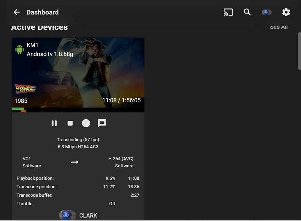

clarkss12 304 Posted January 14, 2021 Author Posted January 14, 2021 (edited) By comparing the playback of a VC-1 video codec on a device that does NOT natively support that codec using Emby vs Plex, Plex is NOT fluid, compared to the Emby playback. However, with the hardware decoding enabled on the Emby server, the video plays for a few minutes, then crashes to the desktop....... With hardware decoded disabled, the video plays perfectly............ I tried to disable just the VC-1 hardware decoding, but that did not seem to work, it still used transcoding. Bottom line, if I did not have access to this transcoding information, I would be happy as a lark. Ignorance is truly bliss. If the video plays perfectly, does it really matter if it is software or hardware decoded??? Edited January 14, 2021 by clarkss12 1
