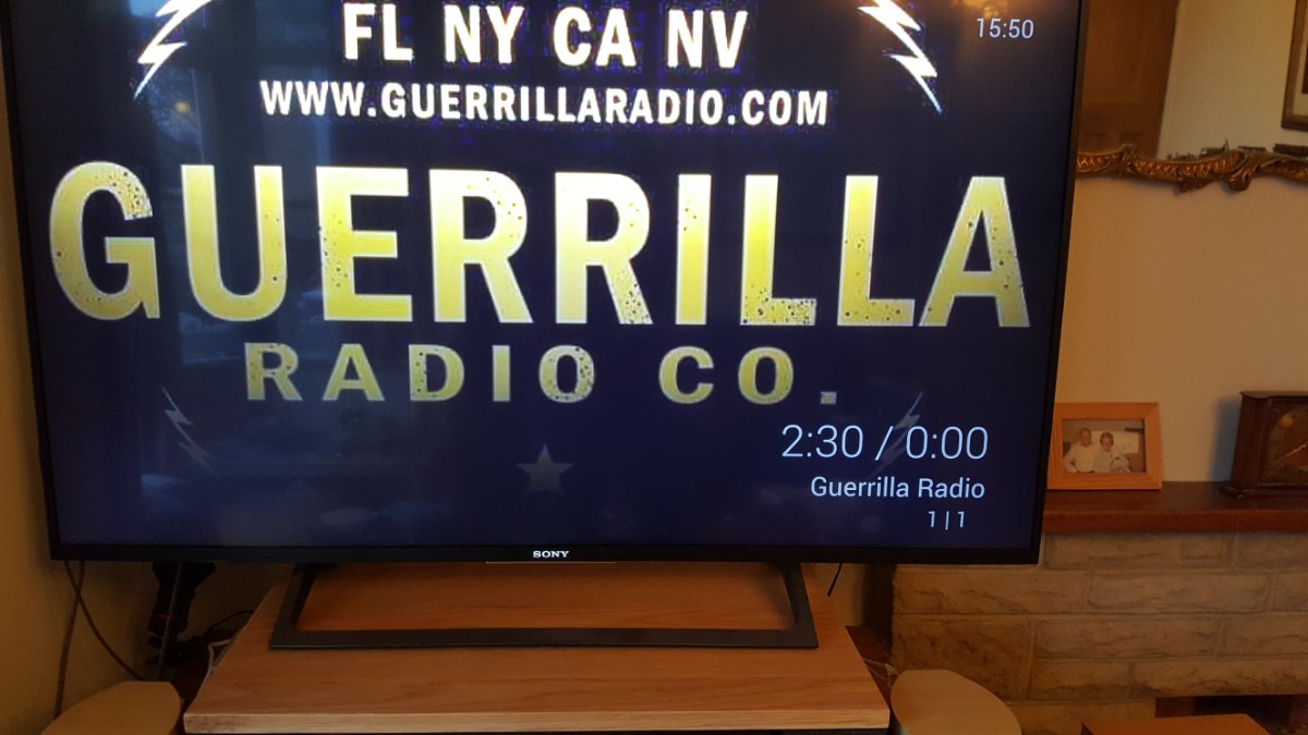

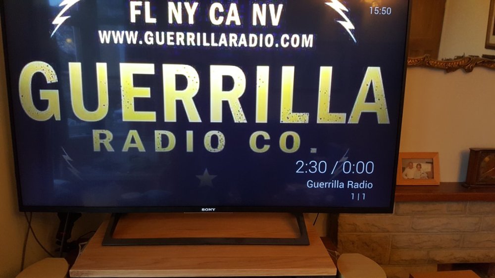

Carlo 4561 Posted January 12, 2021 Posted January 12, 2021 OK good so far. Can you provide a picture of what this looks like on the Firestick when playing back a radio station like this?
Chalklands 27 Posted January 12, 2021 Author Posted January 12, 2021 Hi, Yes, picture attached. I uploaded the backdrop picture. So the screen is showing: Current time, Time played so far and the name of the station. Not sure what 1/1 signifies. Hope that helps. Thanks
Carlo 4561 Posted January 12, 2021 Posted January 12, 2021 OK so what is missing from this view? You're not going to see anything to do with the current show or song being played as there is no way for Emby to know this at all. 1 | 1 is saying this is 1 of 1 items. Take a look at this same thing in a movie library and it will likely make more sense. If you have 500 movies and your selector is on movie 10 it will be 10 | 500. Quick easy way to see how many items you have in that library and your current position.
