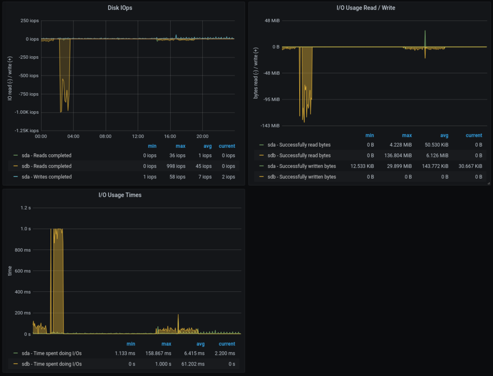

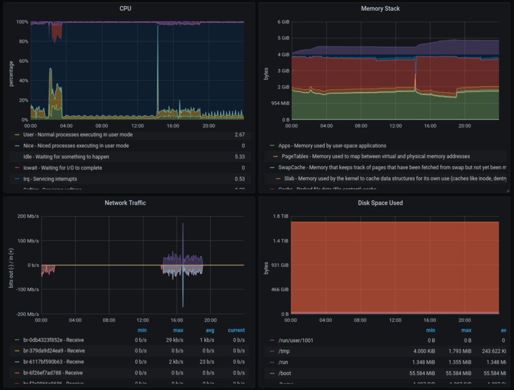

elvetemedve 0 Posted January 14, 2021 Author Posted January 14, 2021 Quote But this is controversial as codecs and bitrate will be different. That's true. Just wanted to check if there is nothing fundamentally wrong with the TV. Quote The log only show two big hiccups that I can see. Good observation, but still does not explain everything. As far as I can tell Emby Theatre streams the video by requesting ~5 minutes chunks, based on the timestamps in the log. So it depends on when it will ask for the next chunk. For example if it always buffers the next one while paying the current, a ~33 seconds delay should not have effect, because there is still 4 minutes 27 seconds remaining from the first, when the 2nd becomes available. Here is the system resource usage below from that day. I haven't spotted any issue that keeps repeating during playback.
