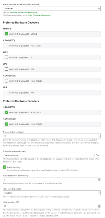

A_Aron 1 Posted January 10, 2021 Posted January 10, 2021 I'm having a issue with any 1080 Bluray movie that spikes or plays over 25mbps. The screen goes all wonky (image attached) for a few seconds then goes back to normal when the framerate drops back down. It happens usually in action scenes. Weird thing is that I don't normally see this issue in 4k rips that I've done. Like Finding Nemo currently watching at 110.3 Mbps. Logs (that I see) aren't showing any type of error at all. Specs: Hardware: i7-8700K Intel 630 (adv transcoding) 48G PC3200 Ram 250G SSD (nvme) 10G Mellanox Fiber card to 10G switch OS: Distributor ID: Debian Description: Debian GNU/Linux 10 (buster) Software: docker-ce/buster,now 5:20.10.2~3-0~debian-buster docker-compose version 1.24.1, build 4667896b I have tried enabling/disabling transcoding there is no difference. ANY playback over 25mbps with 1080 content gives me that glitchy issue. Plex (same server, and setup) does NOT have this problem, it's just emby.
mastrmind11 722 Posted January 10, 2021 Posted January 10, 2021 what happens when you don't use hardware acceleration?
A_Aron 1 Posted January 10, 2021 Author Posted January 10, 2021 1 hour ago, mastrmind11 said: what happens when you don't use hardware acceleration? Exact same thing... I'm only using hardware acceleration (AFAIK) on MPEG2 streams for watching live TV on our Roku's. It also happens when i use a web browser or even the Emby Theater app.
