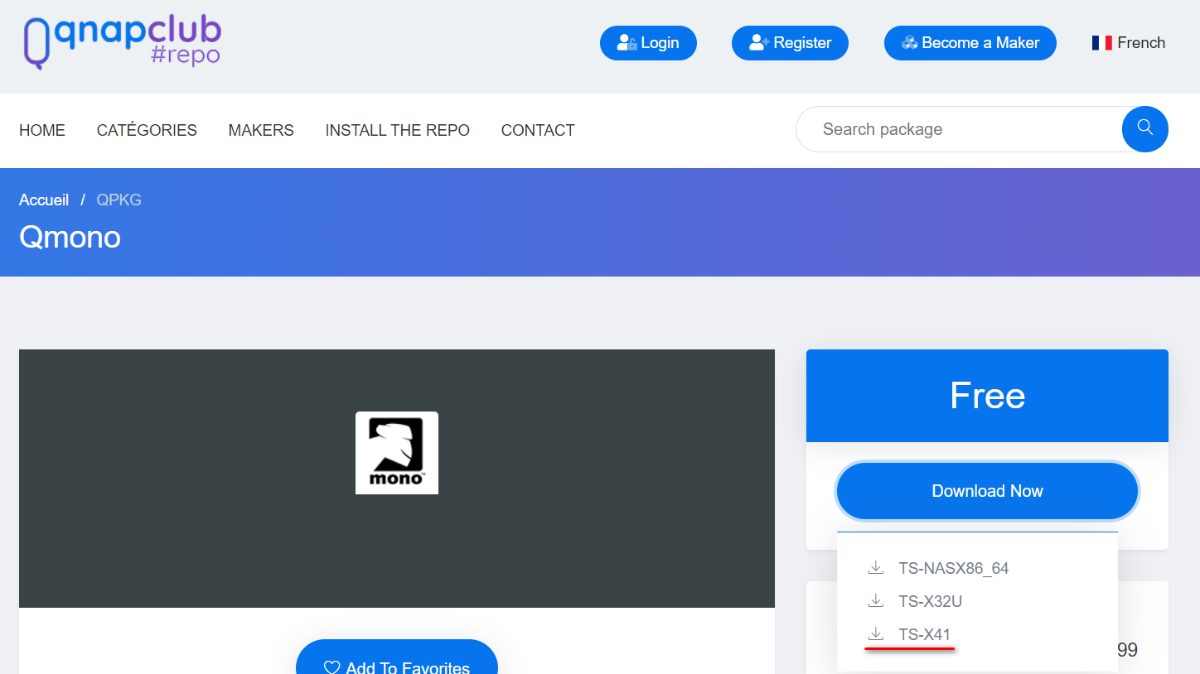

I reread what you dropped and did not understand. What else did I do: installed Qmono 6.8.0.105._arm-x41(in the screenshot),
and also tried the versions that you and another user wrote, namely 4.4.2.0 and 4.4.0.40, this did not solve anything.
